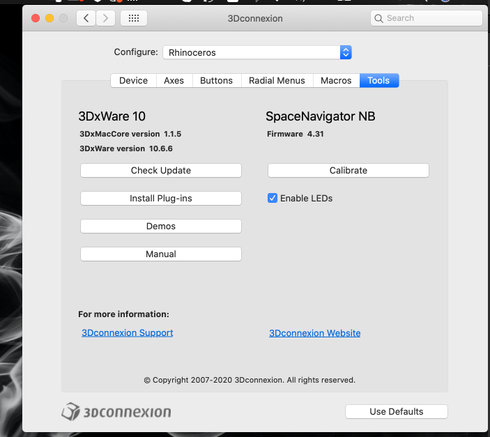

I’m using an 8 years old Late 2013 2.6GHz MBP Still with Catalina.
wasn’t going to upgrade at all, but for the WIP.
because the space navigator [for notebook] is a discontinued model… it’s not clear at all from their website if it will work with the Beta driver. Last time I did a driver update [as mentioned in initial post] it took a few days of down time to sort it out.
