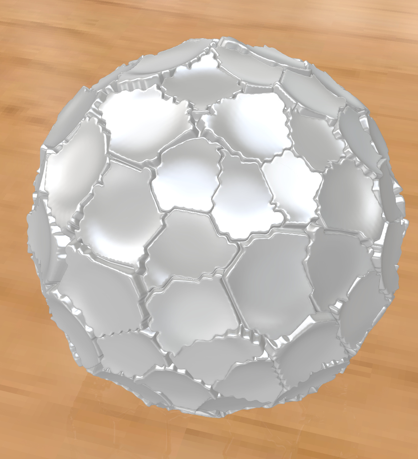

Hello
There are many discussions on this type of subject, here my contributions
https://www.grasshopper3d.com/forum/topics/rocks

Hi Laurent, is there anyway I can create the shapes you made on the rocks on a flat surface?
I dont think it has to be this complicated.
Hi
for sure it is possible, you just need to have a high number of faces on your flat mesh.
So remesh with whatever tool you want (tri-remesh then subdivide, Brep remesh …) then apply the algorithm.
Hi Laurent.
I found what i am looking for in another thread of yours.
The polygons look really smooth and are rounded at the edges where they meet.
This looks really good, but the problem I face is that I need a big surface. 5 meter x 4 meter. I can’t seem to scale it. It doesn’t work then.
Also I don’t want the different sizes of polygon cells.
Do you have a solution for this?

Hello
I am not sure if you try the script without understanding or if your computer is weak?
For understanding a script you must go through all the parts. Some are Units agnostic (divide curve by a number for example) some depends on the units. For Dendro it clearly depends on units. So if you work in mm with a size of 5000 mm and step of 0.15 mm you will have big problems.
here I gave a try reusing various script from @TheCyclist and @DanielPiker
Closed double precision polygon mesh: 6 161 770 vertices, 6 161 770 faces with normals
Bounding box: (-2499.92,-1499.98,-100) to (2499.92,1499.98,-0.102231)
So units here are clearly millimeters but size if like what you want.
Mesh is not simplified but could be simplified inside Dendro or outside.
Here some explanation on the script. But please try to understand the functions and parameters.
