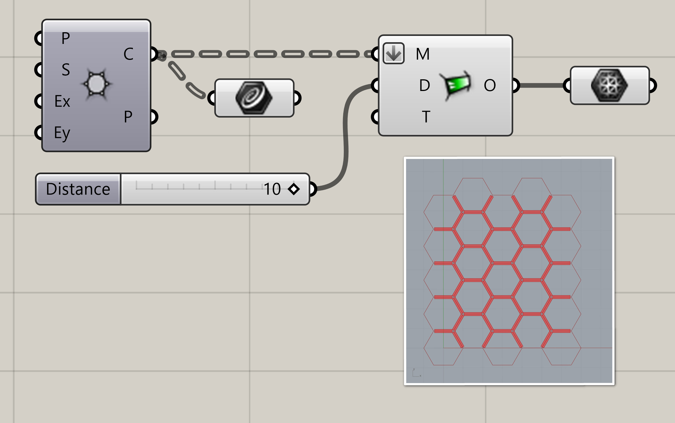

Weaverbird has a bevel mesh edges component which could be used as a start…
This isn’t correct (yet) and definitely isn’t “simple” :red_exclamation_mark: :roll_eyes:
tesselation.gh (20.9 KB)
tesselation a.gh (28.9 KB)
