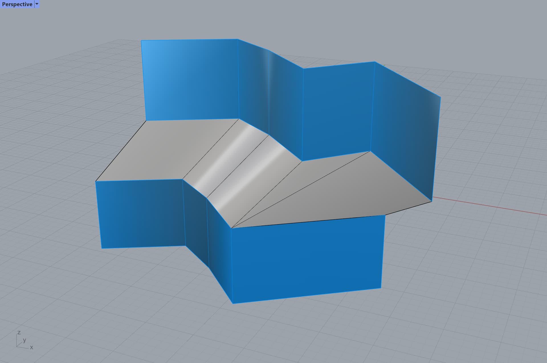

Hi Pascal,
The result is the same, the difference is that I want to use Bridge because Bridge is more heavily used and I just have to right-click to re-invoke Bridge again. Also on one side, I might have an edge loop, on the other side a curve, or polyline. This mix in inputs to create geometry is extremely common in production work. Especially if I’m surfacing around an internal component, I want to use one of their duplicated edges as curves for input.
Rhino has no way to accommodate for this reality.

  1. Bridge only accept a matching number of edges. What kind of nonsense is this? Again, complete lack of understanding of real-world conditions of use.
I expect this result, like in all the other software out there:

in your example of mis matched edge inputs, that result is (as you well know) not a good result for subd.
The problem with your suggestion is creating a tool that allows folks to go way down a path to making a model that is no longer editable or very difficult to edit or fails when you try to get to Nurbs. Tsplines had the same condition limitations for bridge for the same reason.
remember our stuff always has to be able to convert to nurbs, where blender zb, etc does not and as such they allow more liberal inputs.
