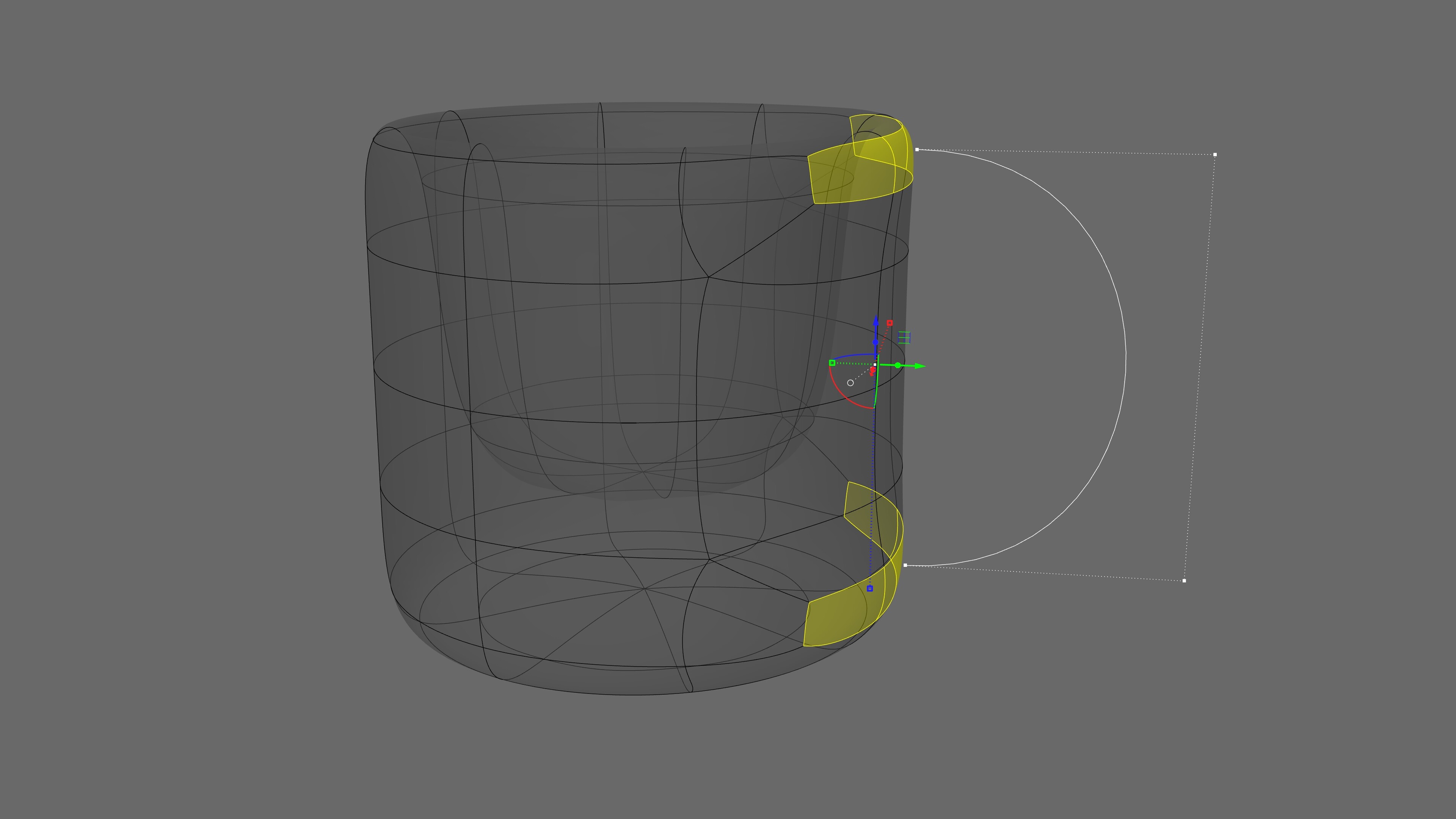

  1. There must be a tool that makes a bent bridge between selected faces or border edges, with ability to change the number of segments and amount of bulging (smoothness).
  1. 3ds Max allows to use a spline to define the shape of such bent bridges, so it will be great of SubD also allows to use curves for the same purpose.

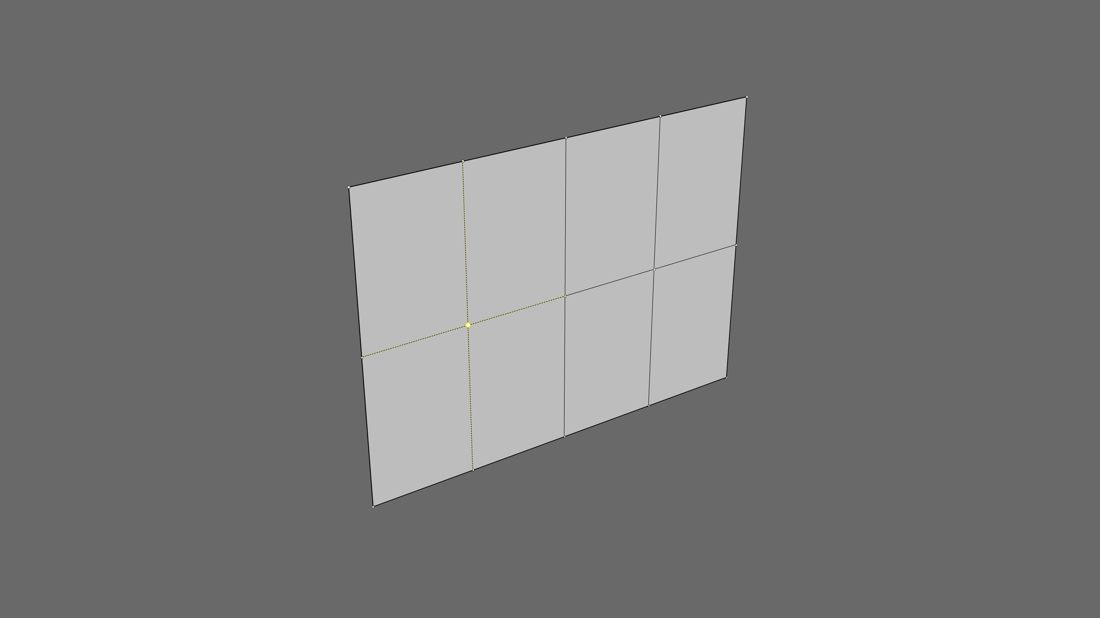

  1. A “Target weld” tool to move and merge a point to another point. Those two points should become a single point. ! _Stitch fails there.

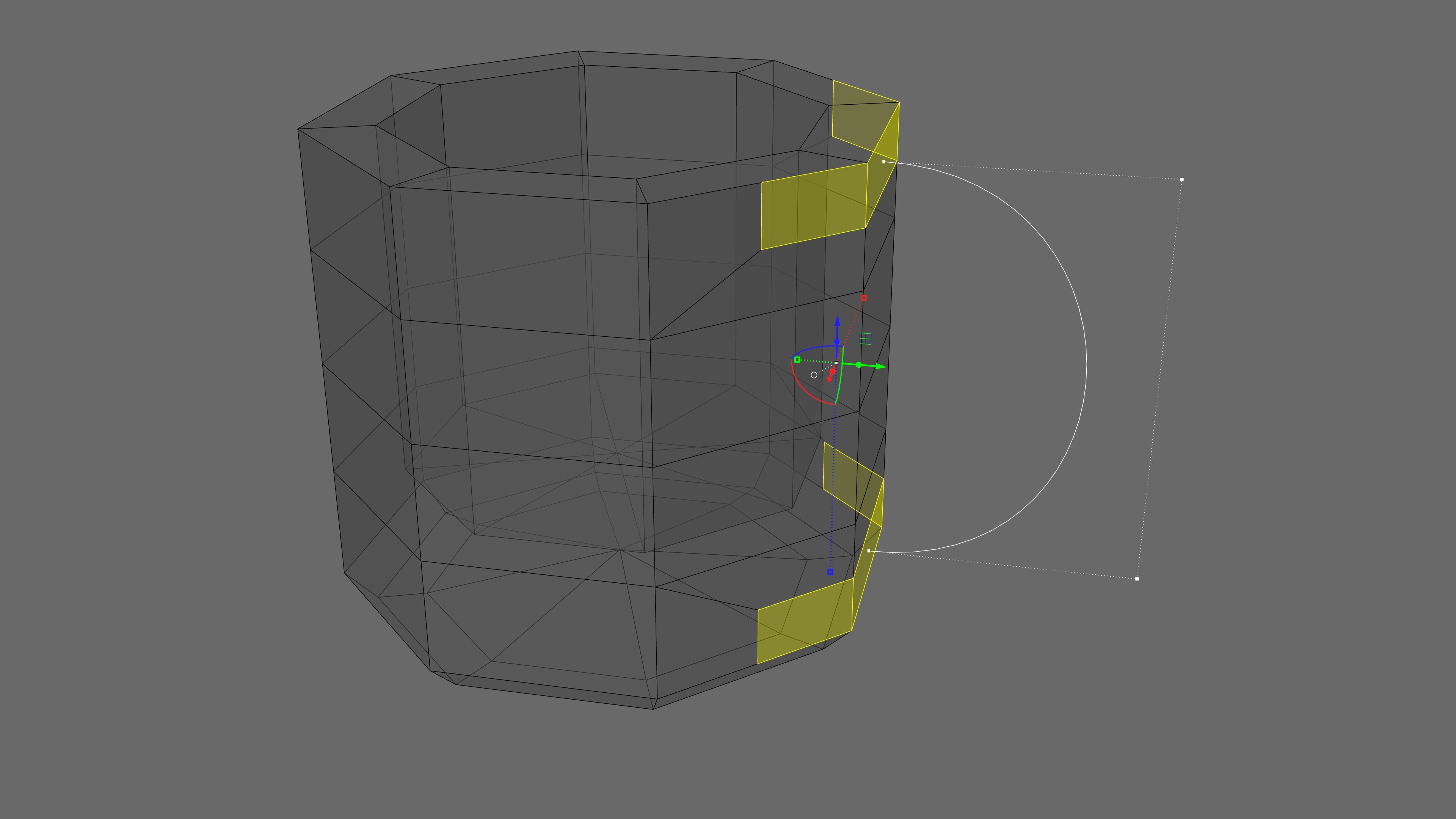

  1. Before Bridge make small extrusion of those faces.
Then delete extruded faces’ caps.
Then make Bridge on edge loops.
If you do not like the result of Bridge, consider SubDSweep1.

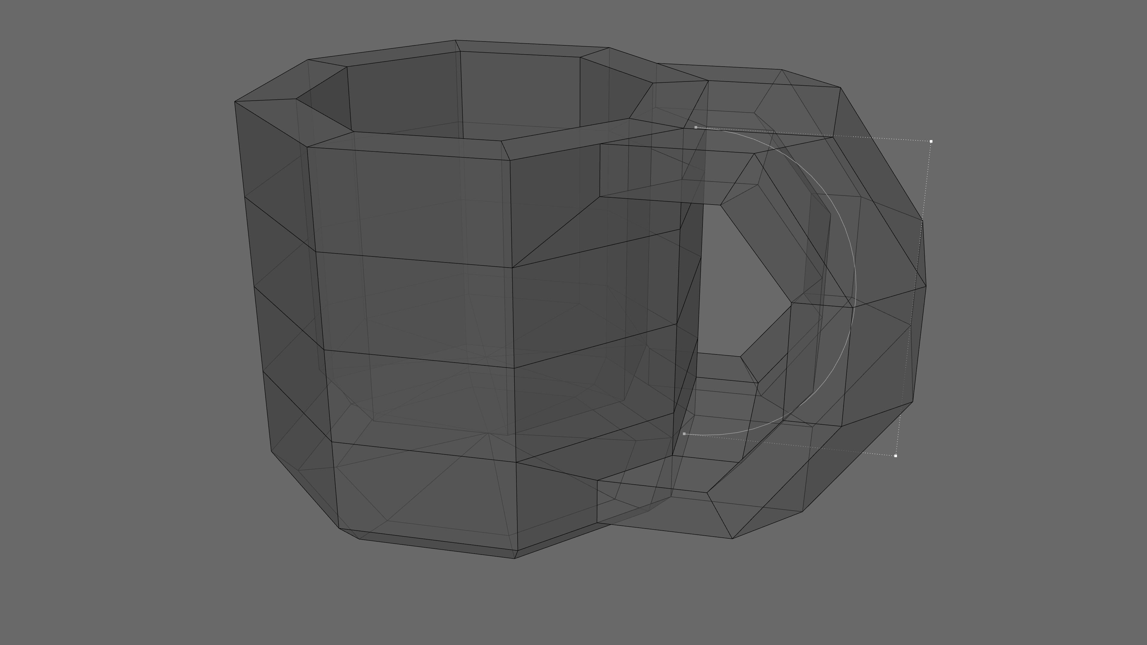

Hi @Screamer , thank you for the nice explanation. It’s pity that ! _Bridge is doing weird things if the input SubD edges are not extruded preliminary, and will only work properly with extruded edges. Here is a comparison between both methods. Note that the settings are exactly the same, but the end result differs a lot:
In my opinion, the “Bridge” tool must take into consideration the normal direction of the two borders and make a better bridge surface rather than trying to connect them in a nearly straight fashion even with “Straightness” set to 0%.
! _Stitch is also counter-intuitive, because its purpose is to literally stitch (combine) two points into a single one, but it fails to do so in so many occasions. Pre-selection should not stop it from doing its job properly. The proper way to do it should be by pre-selecting two control points, then press the “Stitch” icon and… voila, the points become a single point. Just a single mouse click! Instead, Rhino creates a point object with the “!” symbol and the following warning:
“Invalid input geometry.
Defects are marked with dots and defected components are selected.”
That’s weird. I’ve never seen this before.
It happens all the time when I pre-select two points located in the same coordinates (basically I moved and snaped one of them to the other). However, when I run the “Stitch” command first and then click on the same two points individually, the tool works most of the time, but sometimes will still fail. It has some weird conflict with shown SubD control point or when the Filter is set to “Sub-objects”, because then Rhino is confused between SubD control point and SubD vertex, which is literally the same point.
