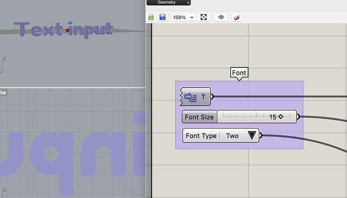

Hi guys, does anyone else have problems when setting the text fonts, I test them in Diver shape by themselves and then they work. But when it’s in the middle of another configuration they don’t work.

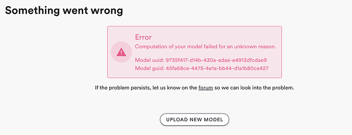

So I still have the same problem in differents files, if I put some font in the text the error happens
when uploading the file. If I remove the source it works
error

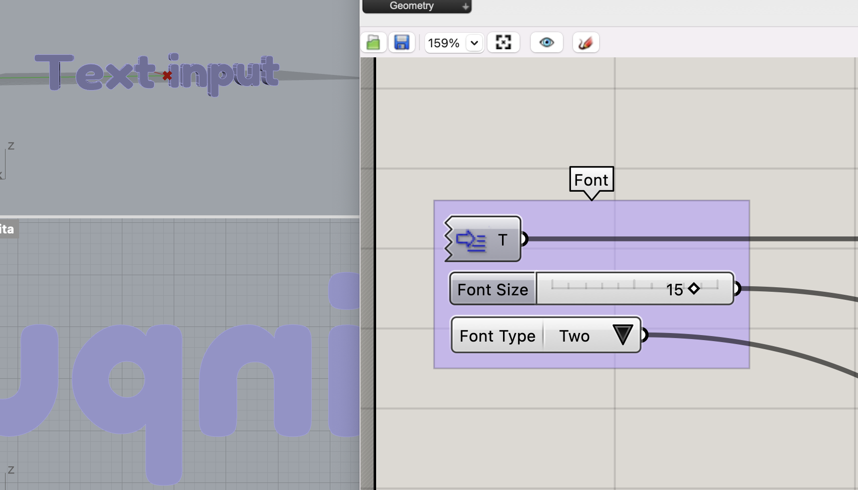

Without the font
