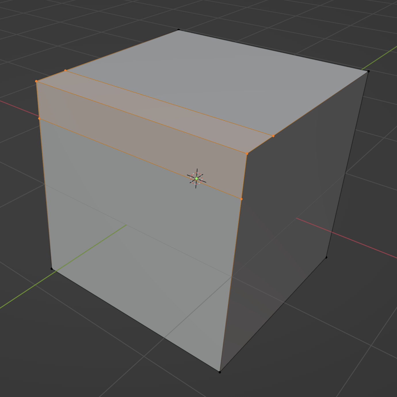

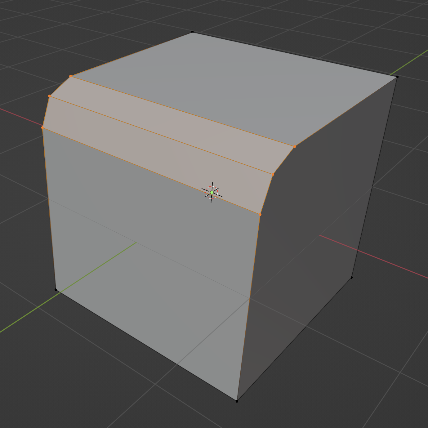

Hi community,
I’m wondering if it’s possible to do the following in GH:
  1. Selecting an edge (orange in the picture)
  2. ‘filleting’ it by adding extra edge loops (the Fillet component seem to only work for Brep)
  3. this either rounds the mesh edges or just adds additional loops
I’m trying to extrude from the naked edges of the top face to make the side walls (so offset, but without the bottom face).
This is a common operation in Blender. Perhaps there’s a different name in GH?
Many Thanks!

I tried WB’s bevel too as well but, as you pointed out, inability to select edges, and also it literally being a bevel (unlike Blenders’ ability to change the curvature of the fillet) are important limitations.
Rhino’s tutorials recommend using three points per corner profile. Doing this is a lot harder if one must create them ‘manually’ as part of the mesh, rather than something we could apply after getting the shape down (e.g. as a modifier like in Blender, which we can remove)
