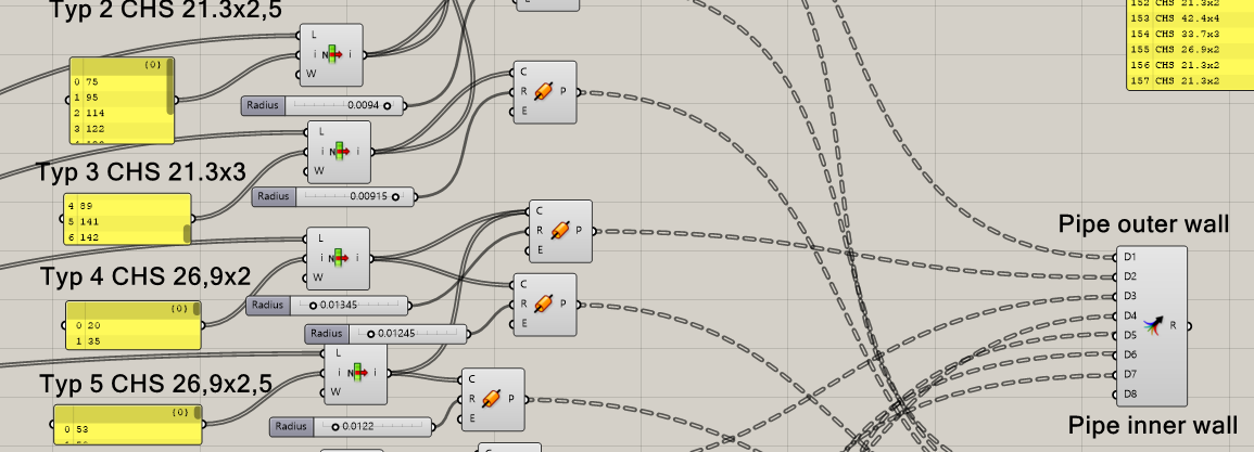

I would like to extract nodes and pipes out of the attached cross-section optimization I did using Karamba3D.
The Goal is to create a push-fit system where the pipes with different diameters (due to the forces) are to be connected to the individual nodes, extracted from their individual points in the pavilion construction.

Hello Matthew, thanks for your help.
I did manage to extract the diameters of the pipes individually through the output of disassemble element.
Now I do wonder, whether there is a more efficient way to sort out the “text” (different measurements)
I receive as an output. ->sort text in comparison to create an Excel sheet, and pipe using the manual diameter and thickness.
extract diameter, create pipes through data in grasshopper.gh (157.7 KB)

One method to make the joints is to pipe all your curves with a solid cross section, then use a sphere at every node do to a boolean intersection operation
