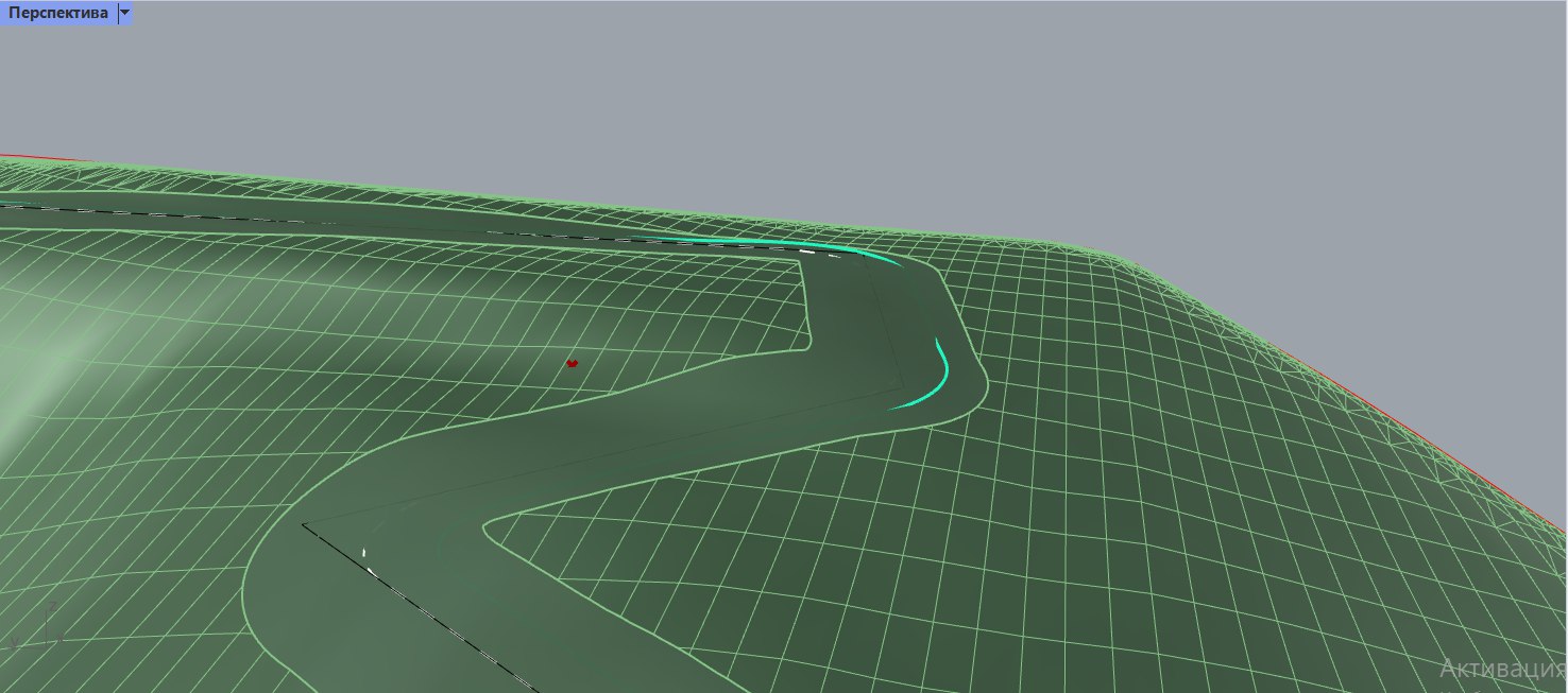

Hello
Now I am looking for a method of finding the building volume of the relief for the created road.
Tell me, did you solve the question you had? Can you help me in my search?
Thank you.
