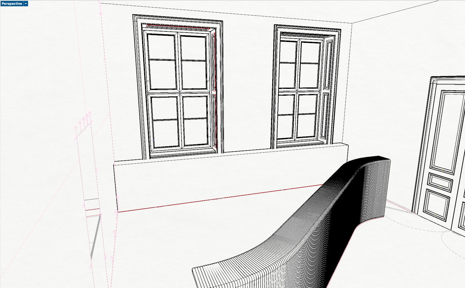

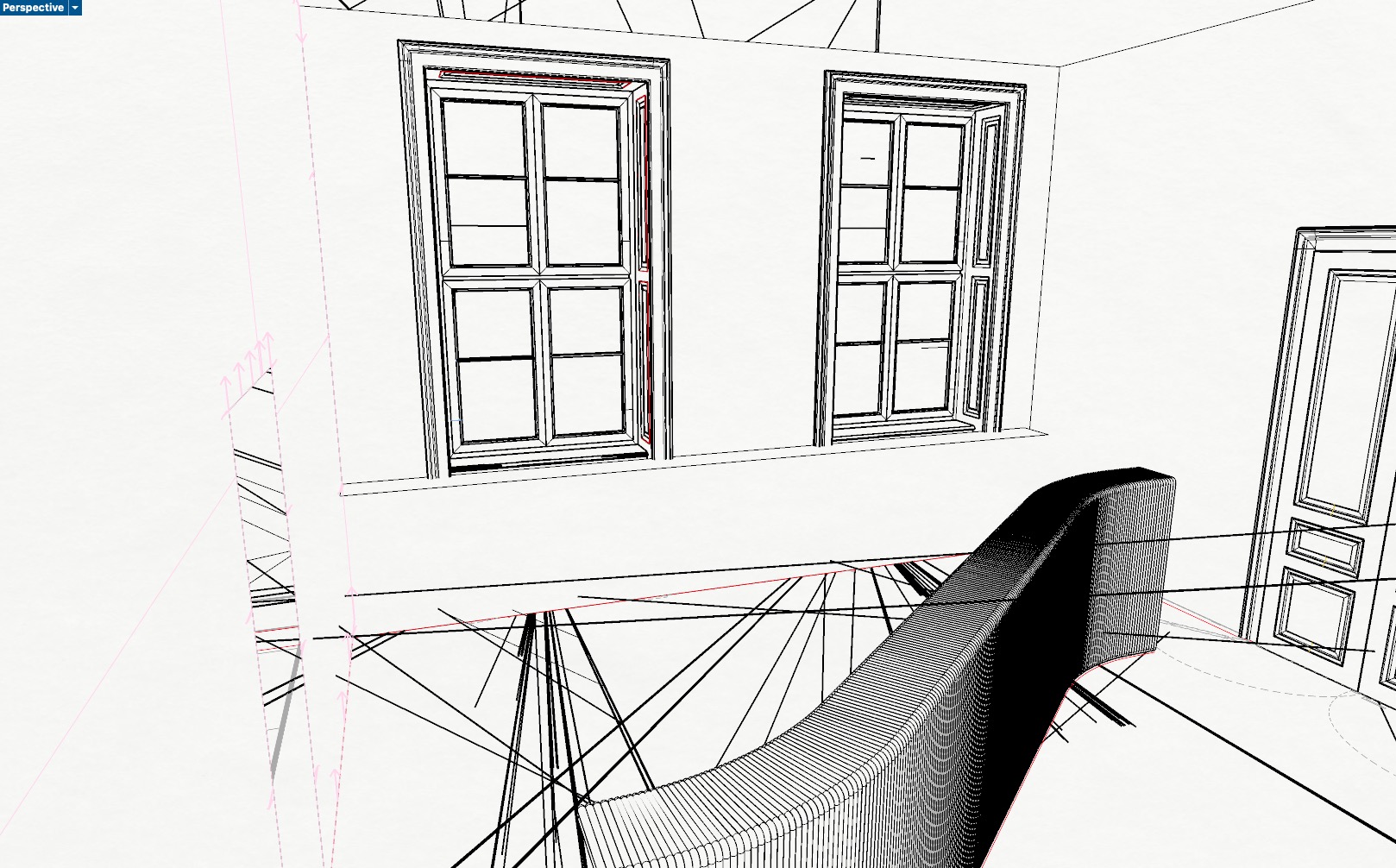

Pen / Technical / Artistic modes display random lines over model aftew few minutes work and Rhino.app needs to be restarted.
Initial view (restarted app):
and display glitches after few minutes of work

@wim still not fixed in the latest beta (Version 8 BETA (8.0.23278.13004, 2023-10-05). See video:
Pen, Artistic etc. modes are completely unusable after few minutes of work.
Hi Jan -
It looks like this issue is limited to Macs running on Apple Silicon, which is why I’m not seeing this here. We have reproduced it on a developer’s machine and this issue is filed as RH-77570 - Random wires with Technical Display
We think we have this fixed now. The fix will be in the next Rhino 8 beta which should be available tomorrow. Thanks

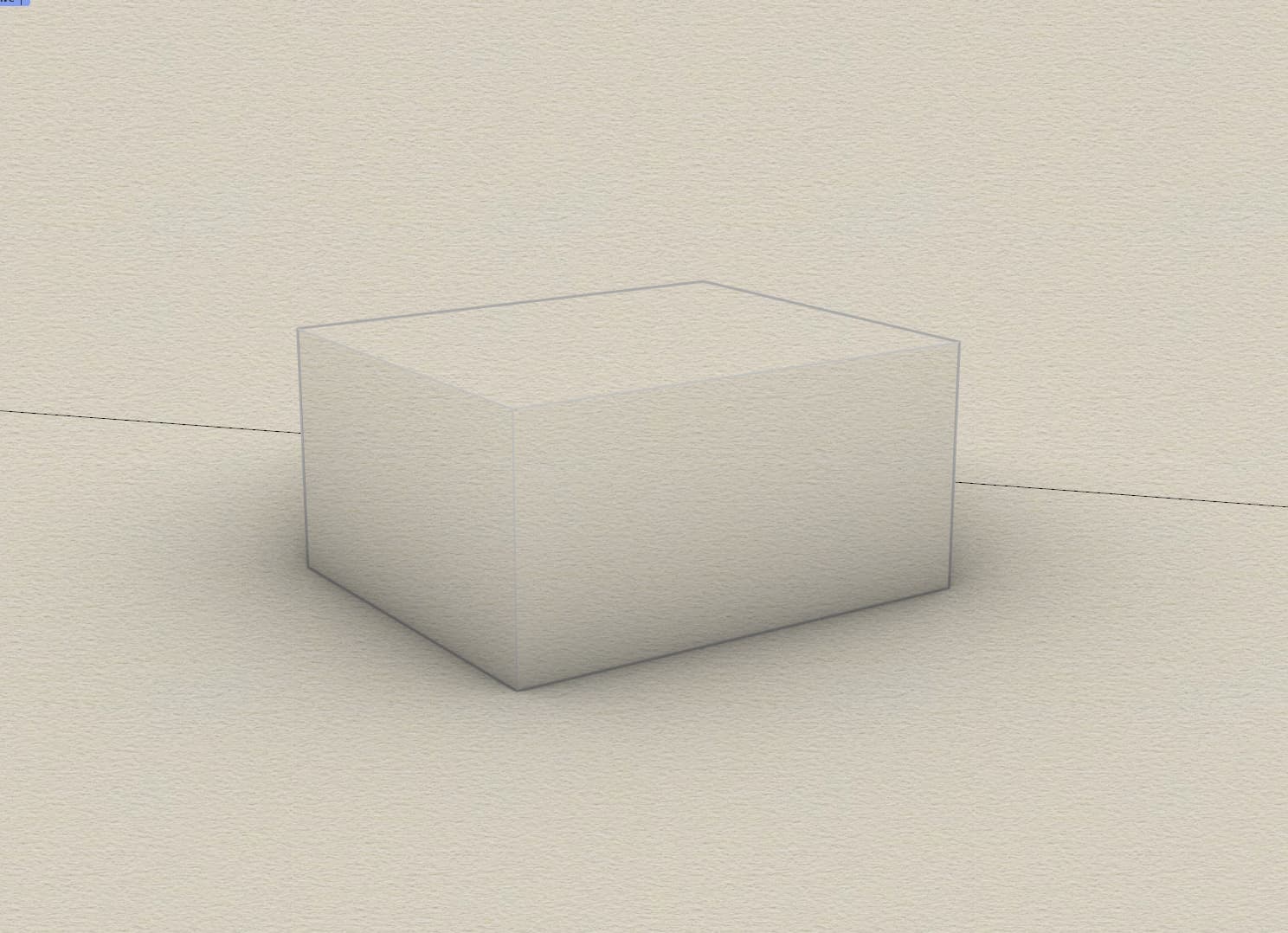

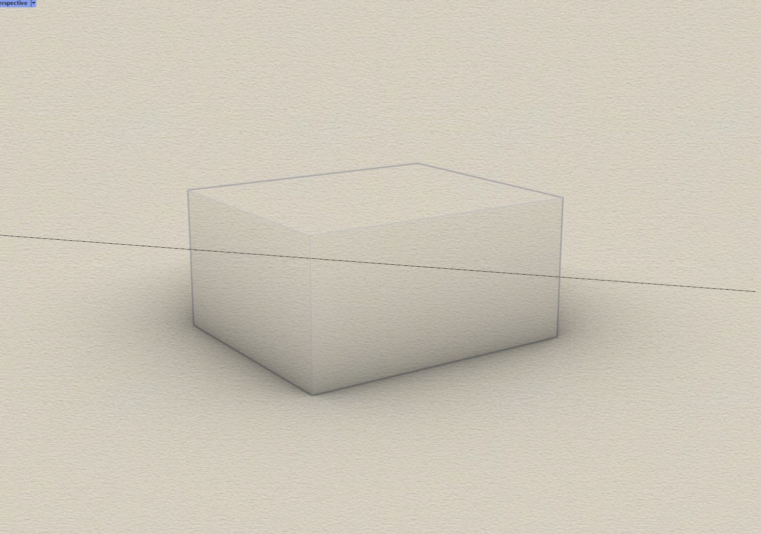

Now some lines are not hidden by polysurfaces in technical / Pen / Artistic display modes. See attached video:
Please post a sample 3dm file if possible. Thanks
@mlkplk
This is not related to Rhino Beta, your lines have a DrawOrder Value, please run the command ClearDrawOrder to fix the issue.
I don’t think DrawOrder commands should be working like this, including display inconsistency between Shaded and Technical/Pen etc. modes.
DrawOrder features are described in man page here:
Yes, and that’s the point. It seems that something happened with your CAD imports that is causing this issue. Once I cleared the draworder, your file was working fine.
I noticed that these lines show up whenever there is SSAO shadows (Arctic, Artistic, Pen)
Running this script will show you that some of your linework has a large margin of values in the draworder, for example the 3D object you have has a value for the display order is to be 0, while the linework is close to -200 (means it is way behind it) . This is probably causing the technical glitch for both V7 and V8.

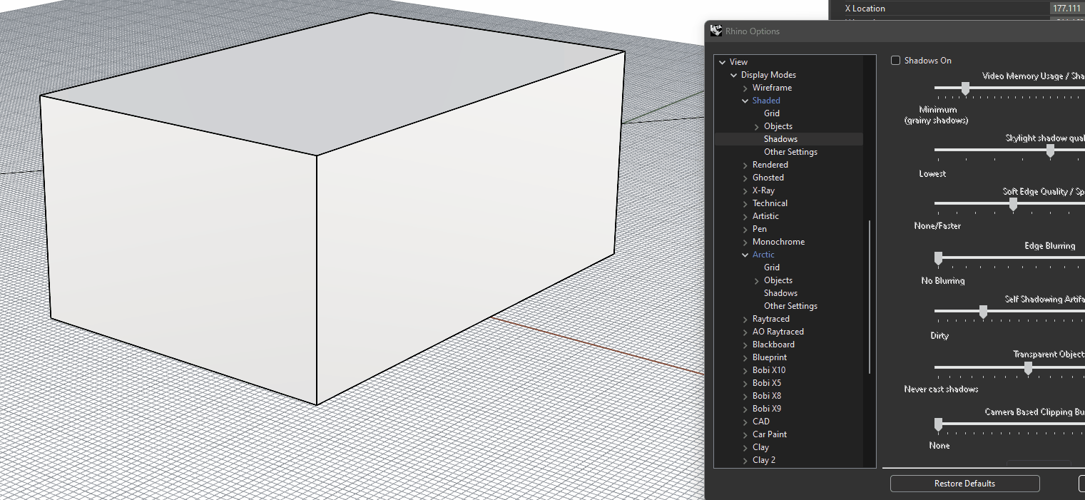

Okay I was able to reproduce the issue on a very simple scene file to find the root cause of the issue.
1- This Behavior is caused bu a combination of 2 factors:
a) The Linework has a Value for the Rhino.DocObjects.ObjectAttributes.DisplayOrder that is not 0
b) Use Advanced GPU Lighting or / And SSAO
2- This Behavior Applies to Rhino 7 as well as the PC version.
To Reproduce the issue:
1- Create a simple box with a line behind it.
2- Set the Display Order for the line to be -1 using the script below:

3- The Results will be like the below:
is it the expected behavior? Obviously no, but it is tricky to track.
also,
can happen for shaded mode once you enable shadows
