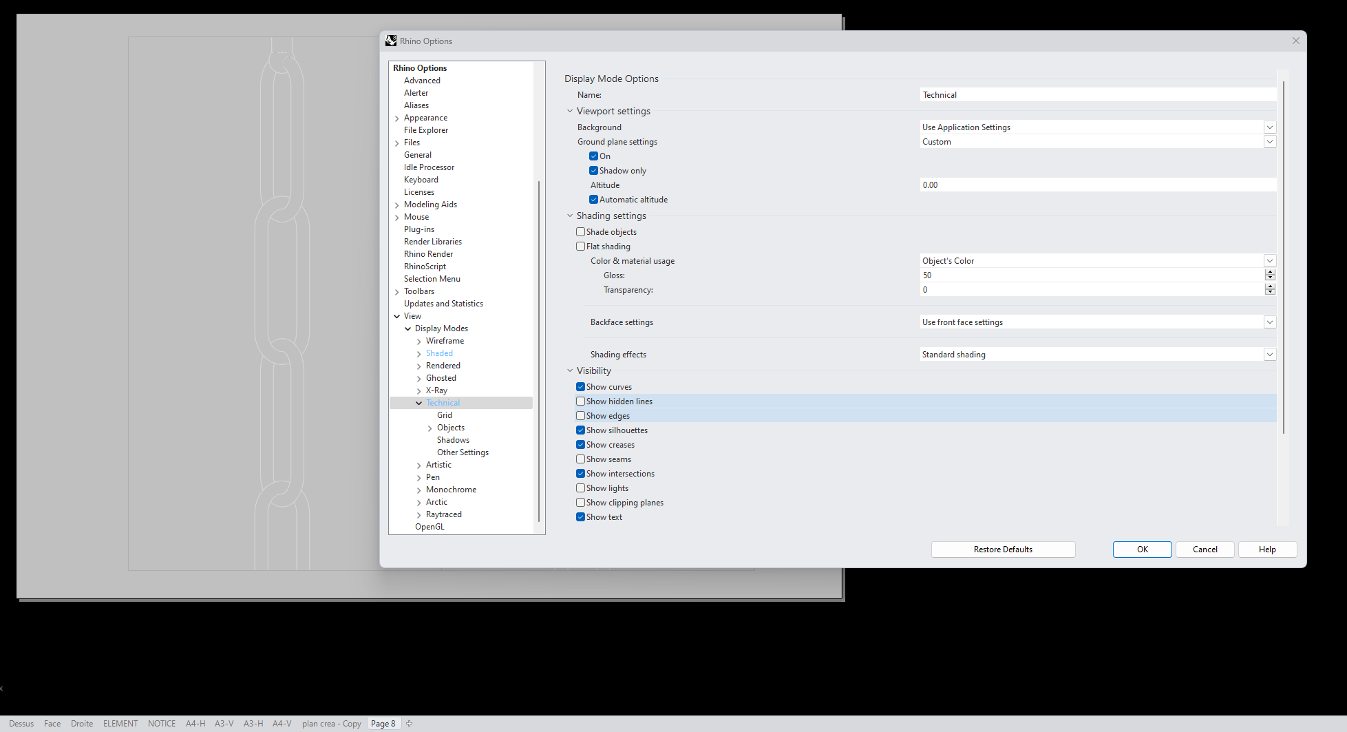

I am facing a problem when using the technical display mode.

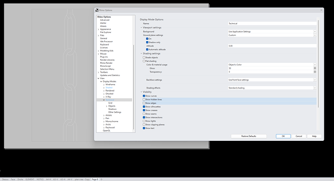

I changed the technical display mode settings:
I unselected Hidden lines and Edges visibility.
It appears perfectly on screen in the layout or working space:
but when printing, Edges are visible while they shouldn’t, silhouettes are partially invisible and some kind of errors occurs:
It is very annoying, would anyone know how to fix this ?
Thank you very much,
Arthur

Hi Arthur -
Please run the Rhino SystemInfo
command and copy-paste the result here. Also, please upload your 3dm file.

Hi Arthur -
Thanks, I’ve filed this as RH-82109 Print: Vector PDF lines issue

12
For those of you not on the Release Candidate update stream, just circling back and confirming that RH-82109 is fixed in Rhino 8 Service Release 8 .
