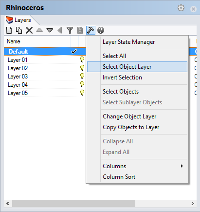

One reply said go to hammer icon and choose ‘Select Object Layers’…but thats no use, it just lost me the layer that was highlighted I had been allocating selected objects to, now I cant find that layer I was using.

With object selected and the Layer panel open, click the Tools menu button and then pick “Select Object Layers.”
Does this help?
Nevermind, I guess you’ve tried this…
yes I did

Personally I don’t use the blue highlight of a row in the layer dialog so I would be OK with using that to indicate selected items.
Just to chime in here. Here is an example of how the blue highlight feature is helpful:

For me I don’t find the status bar layer indicator that useful because 1) it’s almost on the diametrically opposite side of the screen and 2) it’s not wide enough (I often use nested sub-layers to stay organized, then the name gets cut off). Of course everyone uses the software differently, but personally I haven’t found layers in the status bar useful thus far. I do have Layers tab stacked on the Object Properties tab as many others do, but nevertheless it doesn’t feel to me the natural place to look when I’m working with layers (and a bit cluttered for just trying to get one piece of information).
Maybe something like this mockup.:

Typo, it’s ‘MatchLayer’ which is one of several very useful match features, see the autocomplete at the command line when you start typing match.
Steve, if you are still looking for a quick way to ID layernames, this may be of use to you. If you open these V5 scripts in Notepad and copy and paste onto a button (one each to left and right), then the layername of the object picked shows in the PopUp as illustrated. Use at your own risk but it works a treat.
