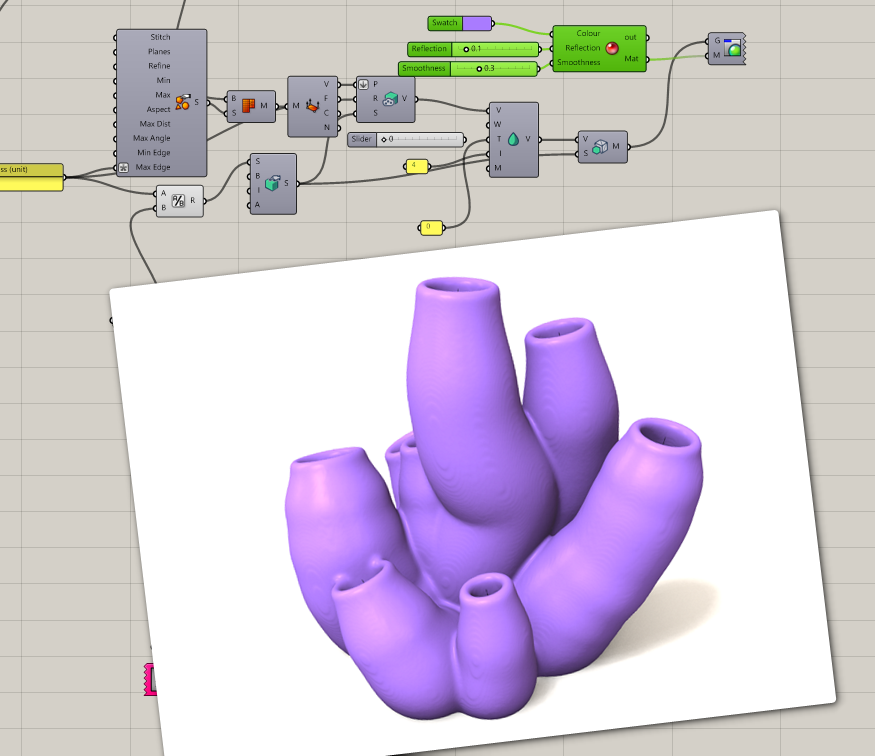

you know could “internalize” curve inside Grasshopper script, so no need of the rhino file. Right click on curve component …
you also could upload image with this button

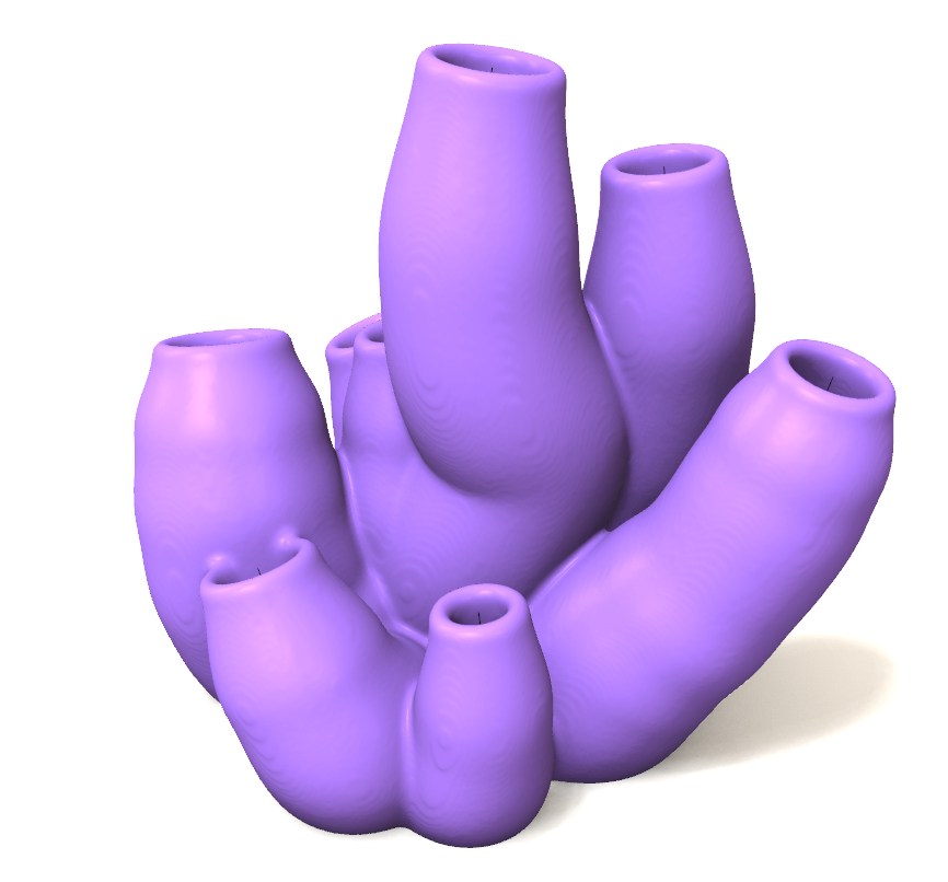

For your problem the most simple, not fastest, is to use isosurface, here from Millepede
https://www.grasshopper3d.com/group/millipede
Or Dendro, that is most recent, fastest …

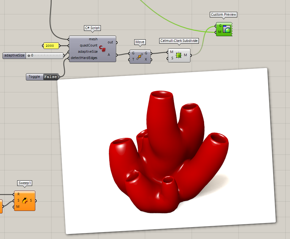

Using V7 it is also possible to remesh it with quad and smooth it very well …
Many many ways, variations …
pipes_for_corals_Dendro.gh (20.9 KB) pipes_for_corals_Dendro-rhino7.gh (32.3 KB) pipes_for_corals_Millipede.gh (28.6 KB)
