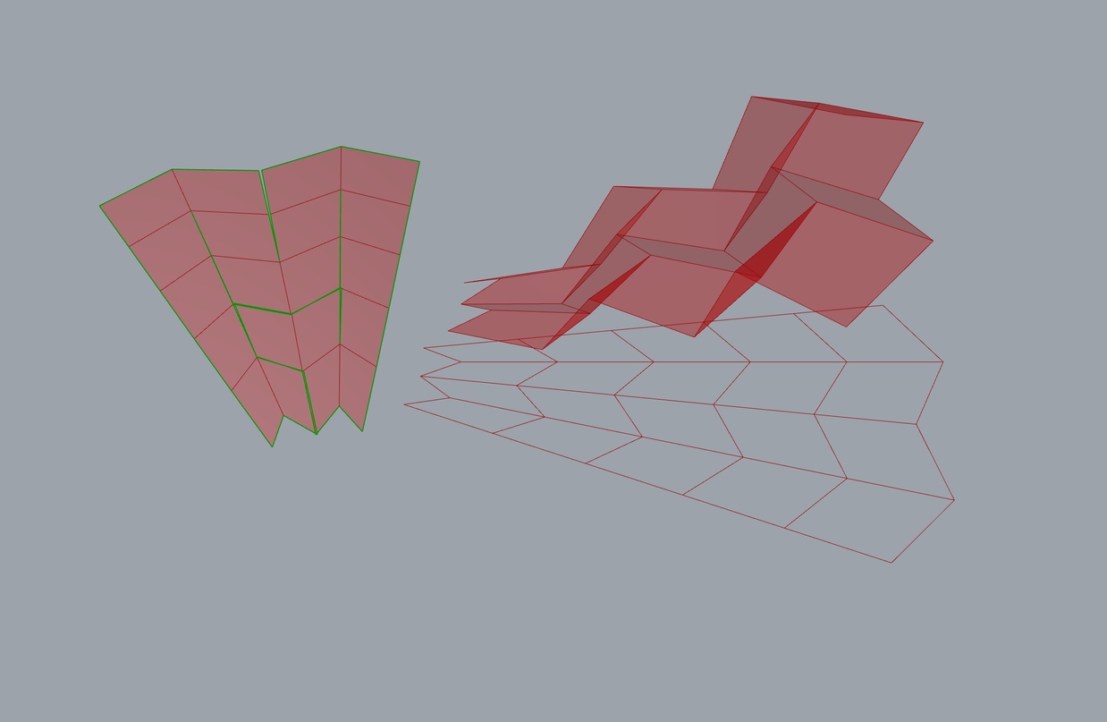

We are currently working on a 1:1 scale origami structure at the university and so I am of course playing around a bit with Kangaroo.
I created a folding simulation of a rotational pattern and it seems to work fine. However when the pattern is unrolled/unfolded again, it does not yield the original shape any more. Hence a deformation must have occurred (I guess?)… This seems to be happing regardless which kind of origami pattern I am using. Even with a simple example by Daniel Piker…
Is there something, I am missing? What can I do to achieve results that are maximally realistic?

wouldn’t your unrolled surface be your original line work to the left? unrolling surfaces will do that weird spacing. Use your original linework to cut. maybe im wrong and kangaroo actually deforms the surfaces when it does the simulation.
Hi @rudolf.neumerkel
For origami including quad faces, you need to make sure you include length goals for the diagonals too.
Triangles stay rigid just by constraining their 3 edge lengths, but without additional constraints on the diagonal, quads can stretch even while their 4 edge lengths are constrained.
If you want to also keep the quads flat, either include length constraints on both diagonals for each quad, or a Planarize goal for the whole mesh.

Hey Daniel, I tried using both strategies - even on a more simple pattern, but it still does not yield the original shape perfectly (see below) / deforms the mesh.

I see you have the strength slider connected to the 10^x, which is the right idea, but a small adjustment I’d suggest is to use the same slider for boundaries, internal edges and planarity, so you can increase them together, and also to use a floating point slider instead of integer, to increase it more gradually.
Keeping it at 10^2 lets you fold it while allowing small distortions, but if you increase it at the end all the way up to 10^10 then you get something without distortion that unrolls to exactly your original pattern.

There is something you can do! You can get rid of these deformations using what I show in the post just above.

It worked well with the rectangular pattern. I then tried to apply the same thing to the radial pattern - but there it failed again. Increasing the exponent, fixes the unrolled shape, but only by also unfolding the mesh as well, bringing it into the flat state again…

Yes - it is quite possible that your mesh is not rigid foldable.
The behaviour you describe does seem to suggest that.
Designing rigid origami beyond the known patterns is not always easy. Most distortions of known patterns will result in something which cannot be rigid folded.
It is possible though with Kangaroo to take a near rigid foldable mesh and optimize to make it rigid foldable. This is a very old video from Kangaroo1 but the principle is still the same:
If you take a folded mesh which is almost developable, and the unfolded version (which is only possible with some stretching), then you can equalize corresponding edge lengths, while keeping the unfolded one flat, to get a true rigid foldable pattern close to your original approximate one. Note that you need to use the triangulated mesh to stop the quads distorting, but you can still keep the quads flat with a Planarity goal, or by triangulating in both directions.
