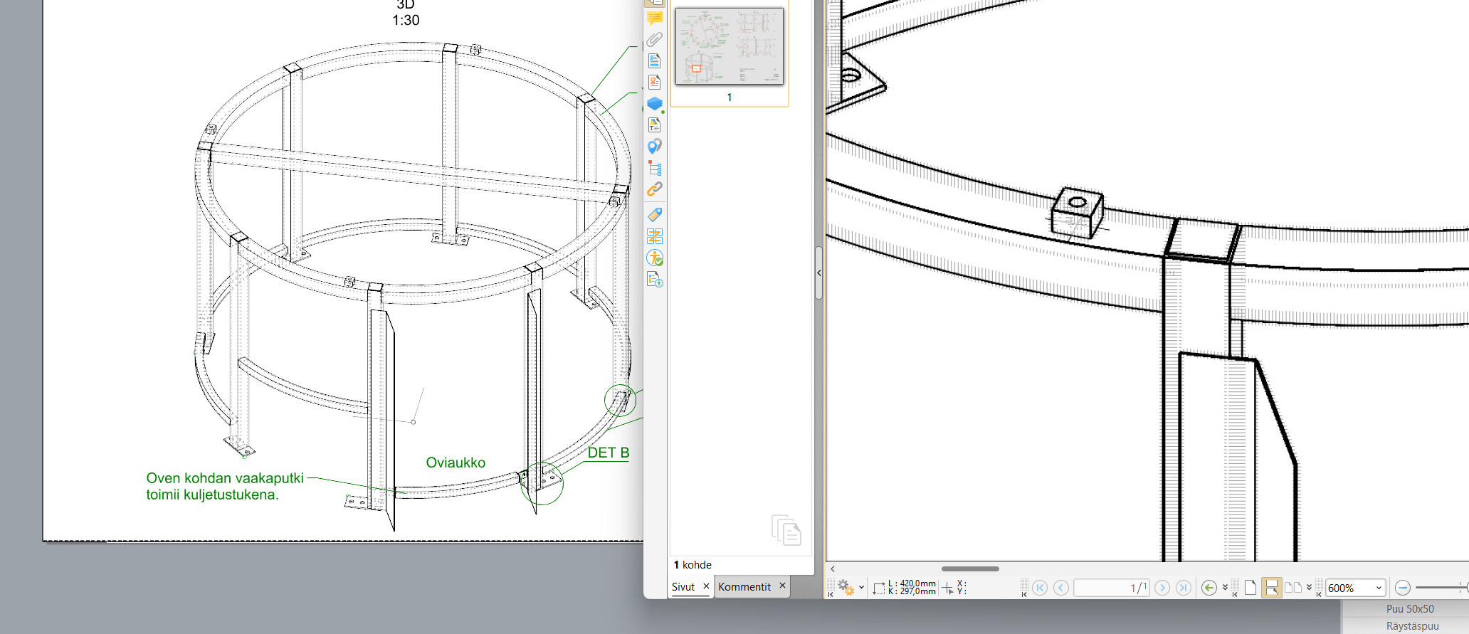

I’m playing around with the Hidden linetype and its correlation to printed PDF.
  • As far as I can tell, the only way to print a non-black Hidden linetype in Technical viewmode is through printing “Display Color”. Is this correct?
  • The Hidden linetype settings control the printed result, but does not affect the display. Got that.
  • There seems to be some overlayed curves or something happening here, rendering the hidden line weird.

Hi Toni -
For the time being, that’s correct, yes.
Yea…
I guess, in real life, those two parts would not have an identical diameter (unless you work with double minus tolerances on your drawings), and those two circles will be slightly offset?
But, yes…

@wim @fsalla @enric
There seems to be a printing bug here still…
VisualARQ beams do not print in vector mode in Technical.
Raster works, but Hidden linetype is screwed.
…just when I was getting excited about the possibilities in avoiding Make2D alltogether…
EDIT:
Interestingly enough, it works if I disable Tibidabo as Beams become just blocks.
So VisualARQ is overriding the Print settings on VARQ objects.
Rh8 SR16, VARQ3.2.0
EDIT2:
If I use BlockTools’ _MakeUnique, it strips the VARQ-layer from the block and everything works as expected. This is a workaround for my immediate printing needs.
Hi @Toni_Osterlund this used to work before (check this post: Hidden Display Mode that can show hidden beam web and flanges as lines - #5 by fsalla ). We will revise this issue again.
