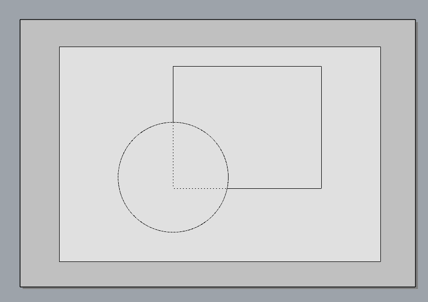

You may want to consider using layouts.
- You can set up multiple views per part
- Suppress layers and objects on a per-layout basis
- Modifying geometry modifies layout views
- Use technical view to properly render hidden lines
- Print to PDF, vector or raster image formats
Example:
This layout shows a sphere sitting atop a box. The box surface has been exploded (it is not a solid). Fig. 1: Top view; Fig. 2: Isometric view.
