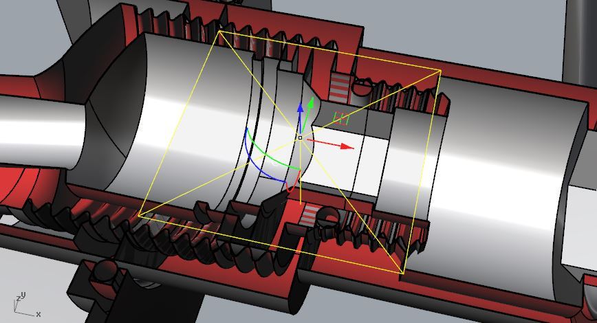

In the attached image there is an example of clippingPlane show Fills Bug.V5 src5
Ciao Vittorio
enter here

Hi Vittorio,
is your object closed ? If not, the Fills currently will not show filled.
Ciao, c.

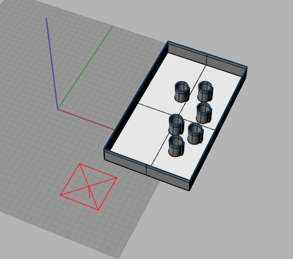

Hi Handy
In the attached file and picture there is an example of problem with CilppingPlane
if i move the object in two positions
Ciao VittorioClippingPlane_Strange_Behavior.3dm (1.8 MB)
(Pascal Golay) #7
Hi Vittorio - here (so far) all positions of the clipping plane do show a filled section- does your image indicate that it comes and goes, depending on the position of the plane?
