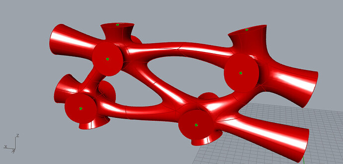

Hi there :slight_smile: fairly new to Rhino 3D and Grasshopper universe. I’m tweaking a script from Parametric House and am trying something with the multipipe component.
I want to have bulging at the end points but don’t want to change the diameter from the inside of the shape, where I highlighted with green. Tried some graph mapper with line distances/ point atractors. Is there a way to select exacly what parts to bulge with StrutSize?

You can use a bunch of circles to set location+radius manually
2023-10-23 17_04_32-Grasshopper - Catena_
Hi @parametric_fart
NodeSize can be set per node as Riccardo shows, but StrutSize is a single global setting, so there isn’t a way to change it per strut from the component inputs.
Instead what you could do is make the outer nodes bigger. Here showing how to select the outer points:
Voronoi 3D + Multipipe.gh (15.6 KB)
For more strut-specific variation, you’d need to do it as a post processing step. If you feed the Multipipe result to a Mesh component you can get the control points, then you could select ones near midpoints of particular input edges and scale them etc.
