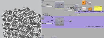

Hello everyone,
I’m currently developing a framework to attach various shapes (cylindrical, square, and convex triangles) to multiple curves originating from octahedral shapes. Initially, I aim to create cylindrical pipes along these curves with consistent diameters. Following this, I plan to explore modifying the shapes of these struts to squares and convex forms.
However, while working on my Grasshopper file, I encountered an issue: adjusting the size of the struts sometimes results in the diameter of the nodes becoming larger or smaller than that of the struts.
My questions are:
  1. How can I ensure uniform control over the diameter of the cylindrical strut shapes (pipes) across all struts and nodes?
  2. Is there a method to manipulate the strut shape, transitioning from cylindrical to square (as shown in the second model image) and convex shapes (as depicted in the third model image)?
I would greatly appreciate any assistance or guidance on resolving these issues.

I just wanted to express my gratitude for your incredible work and assistance. Your Grasshopper file has been immensely helpful, especially with providing the square strut shape. Currently, I’m working on implementing the cylindrical strut shape with the same radius. While experimenting, I managed to achieve the desired shape, but encountered a problem with negative volume fraction when using a single cell of the octahedron. Strangely, duplicating the octahedron cells doesn’t seem to solve the issue. Could you provide any guidance or assistance to help me resolve this?

First, you need to weld your verts
second, you need to flip the mesh normals so they face outward.
But, I don’t think Fatten can do your job. Why not just use Multipipe?

I experimented with using the “MultiPipe” function, but encountered a problem: when I increased the diameter of the struts, the size of the nodes became larger than the strut diameter. My goal is to achieve a shape where all the struts have the same diameter, even at the nodes, as shown in the picture. Any suggestions on how to achieve this would be greatly appreciated.

@Quan_Li, I haven’t yet found a solution to ensure all the struts have the same diameter as depicted in the previous figure. You can access the Grasshopper file I’m working on below. Despite my efforts, I haven’t achieved the desired outcome. The node where the struts converge appears larger than the strut itself.

Use this method, it will produce 100% creased SubD, therefore no fillet BREP.
