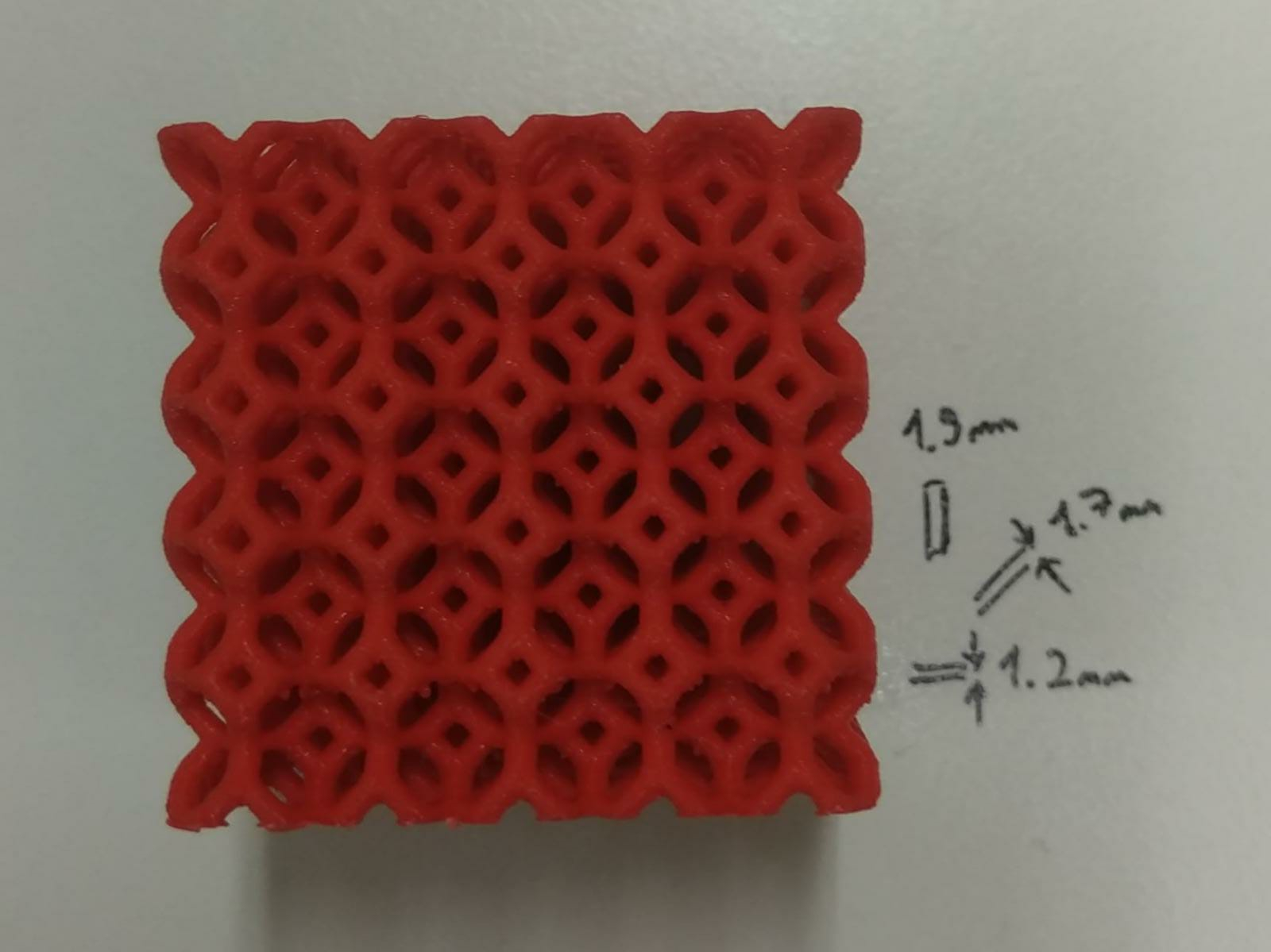

Hi, I’m completely new to rhino. I use lattice structures for my term project and
I need to change the strut diameters in the structure.
here I was only able to set the radius of the struts to 0.3 but I want to make the verticales 1.9mm and the horizontal ones 1.2mm and the angled ones 1.7mm in diameter.Like this picture Is it possible?I would be glad if you help:(trial.gh (10.5 KB)
ExoWireframe used…
Trial_RE.gh (12.9 KB)
thank you very much!
