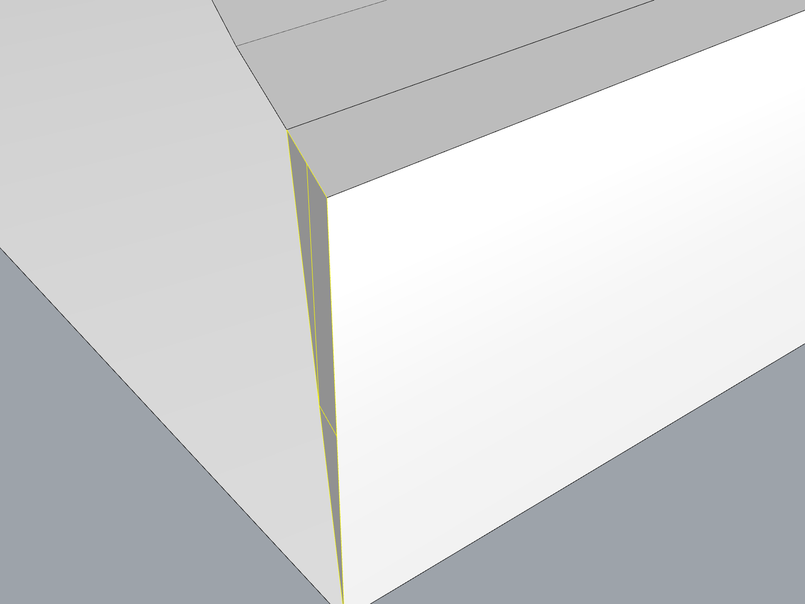

Hey all, i have a cross section that represents an existing cross section in layer 2 red, made from a number of different curves.
When lofting the curves I’m unable to generate a solid, I’m not sure why a solid is not created.

In your file only 2 tiny caps are created. Try to make your loft-curves planar if possible, you will need just 2 of them for lofting.
