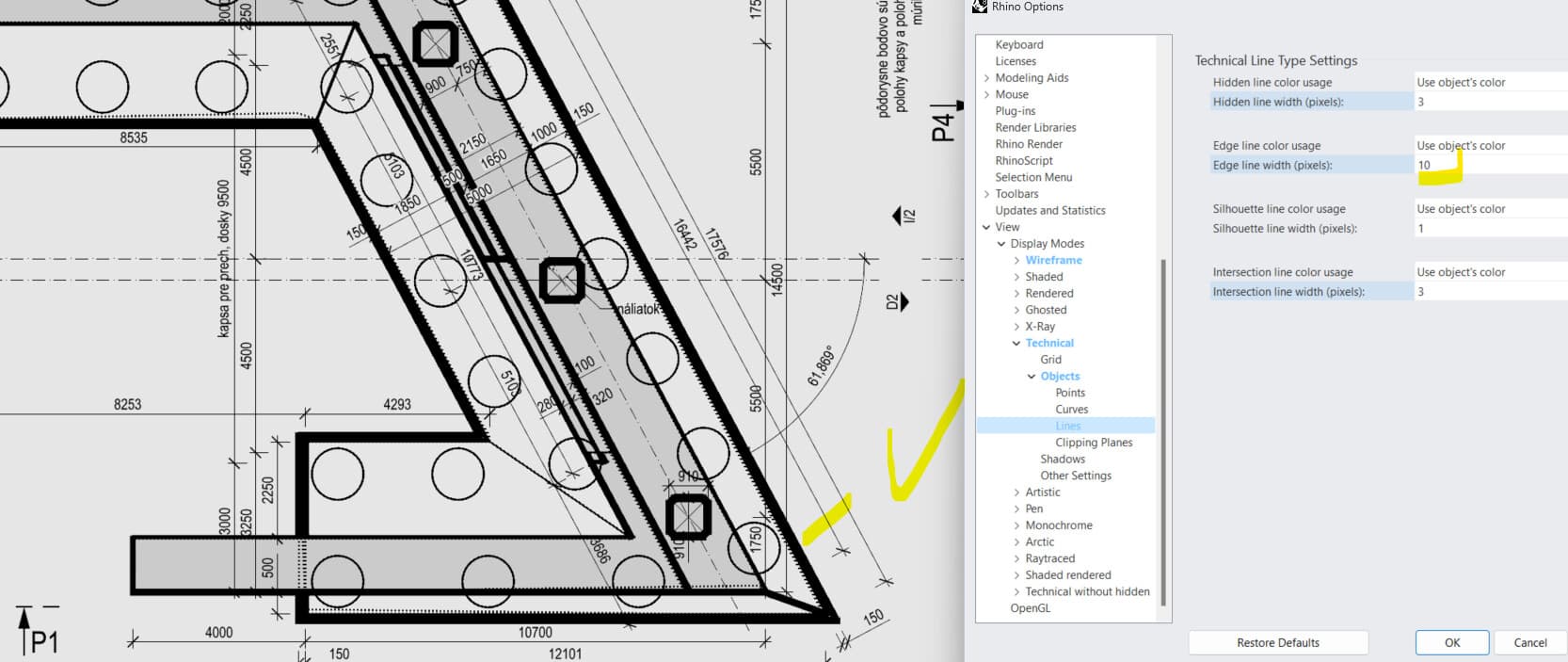

BUG suddenly technical display intersection lines are too thick
i dont know which version changed it but suddenly my intersection lines in technical display print too thick!
i cant express how furious i am yet again that my pdfs look always different…

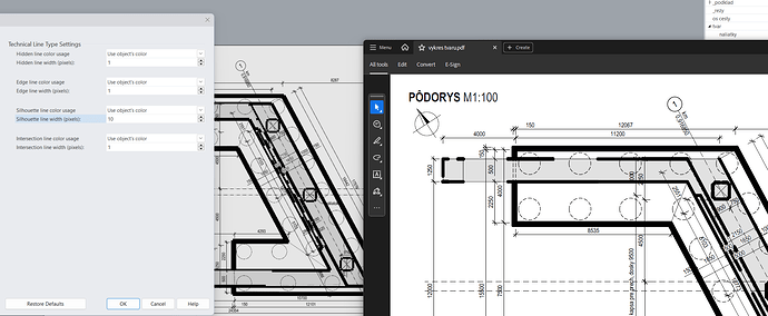

in mine intersection lines are way thicker

this seem to have no effect now. it used to have… in raster it does in vector it does not. there is something very screwed in the code.
when i increase hidden line width it actually gets thinner, others have no effect
i have to say i have never seen something so simple so unreliable. are we battling with lines widths 17months from the release???

I can play with thse line width which have effect in layout but are not printed in vector pdf. It used to work.

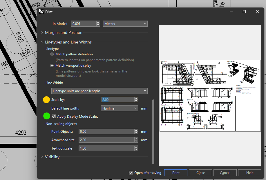

Hi Juan, Do you have Apply Display Mode Scaling checked? The Scale By can be used to bump the thickness a bit if need be.
Linetypes can be units other than pixel for more exact control as well.
yes

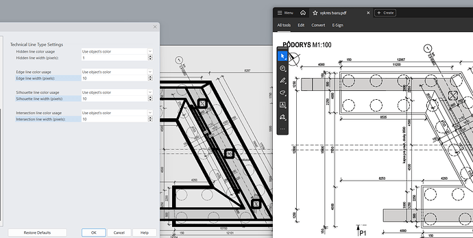

no, i dont need everything to be bumped up, i need these factors
not to work only in layout but also in PDF output.
There is something very strange and obviously so wrong:
