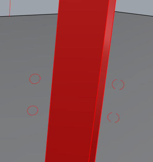

Hi guys, im trying to cut the following brep witgh the sphere that I’ve made, but somehow it only cut several panels, and the other panels left in an opened curve. is there any solution for this? thank you

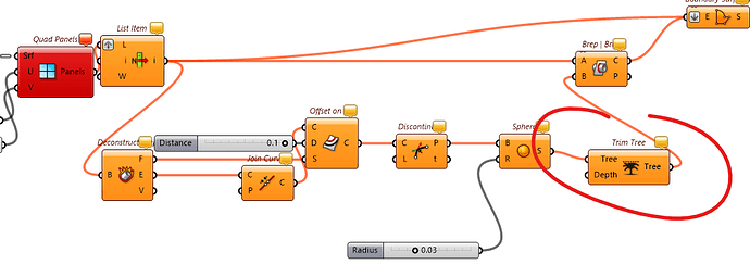

I think there is a data tree mismatch there, try to add Trim Tree.

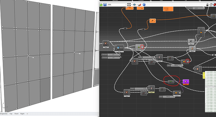

My bad, this is my internalize gh files,

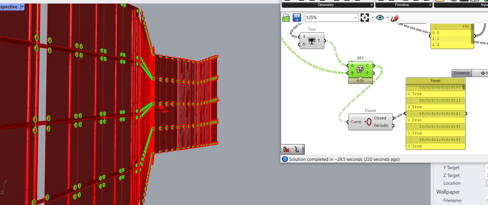

i added the trim tree but it still doesn’t work, with trim solid I’m able to make the hole but I’m not able to get a whole joined curve.
Truss mahkota.gh (53.9 KB)
