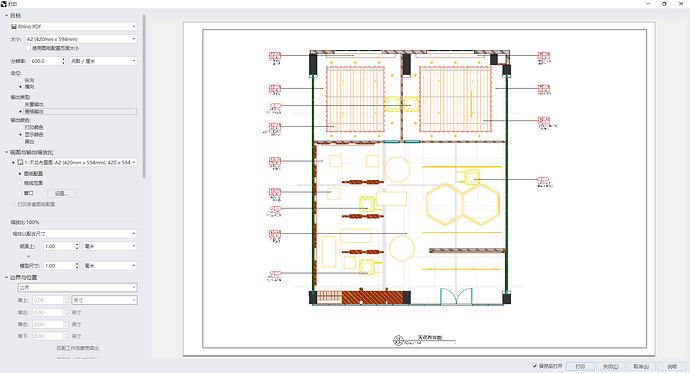

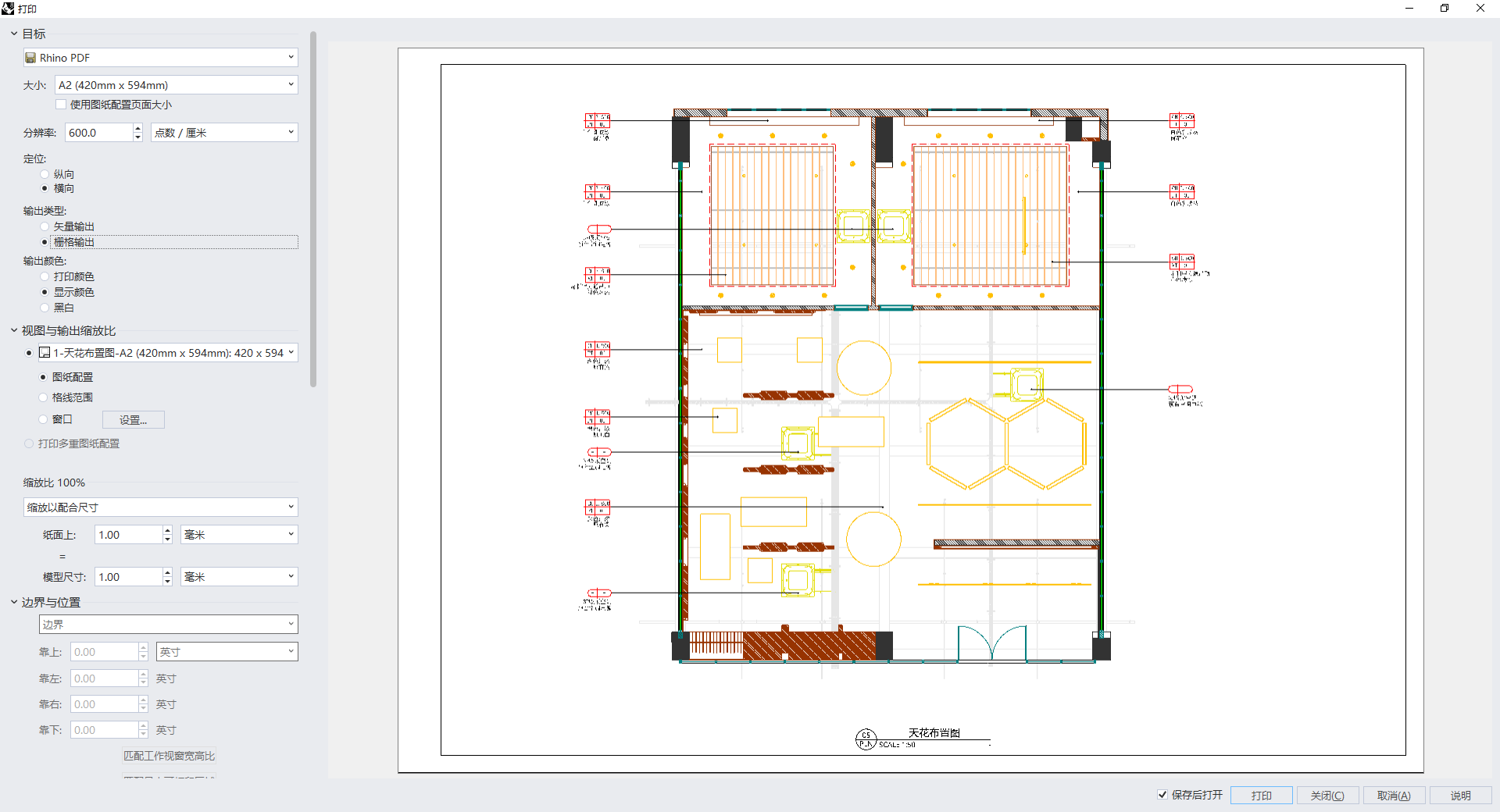

Hi. I am able to see the the detail view drawing inside the layout space but once plotted, the drawing is missing in the pdf print. Also, there are artefact on the reflected bottom of beams:
layout space:
pdf export:

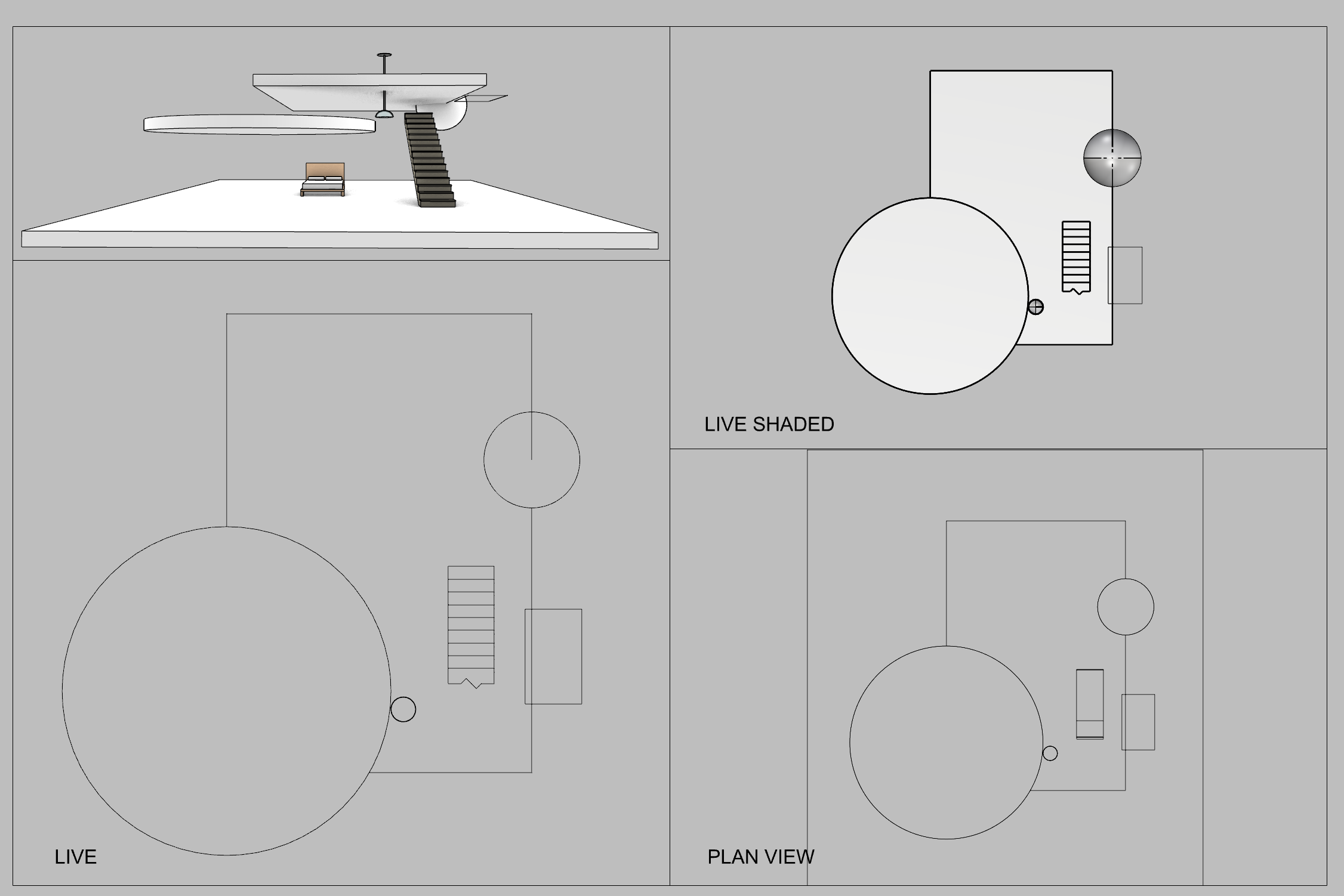

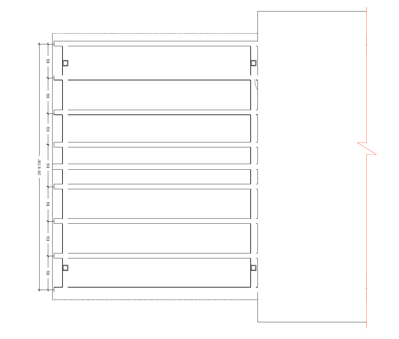

Jumping in, I’ve also got some plot issues for RCPs.
Should be:
I’ll message a file. Thanks as always! -C
