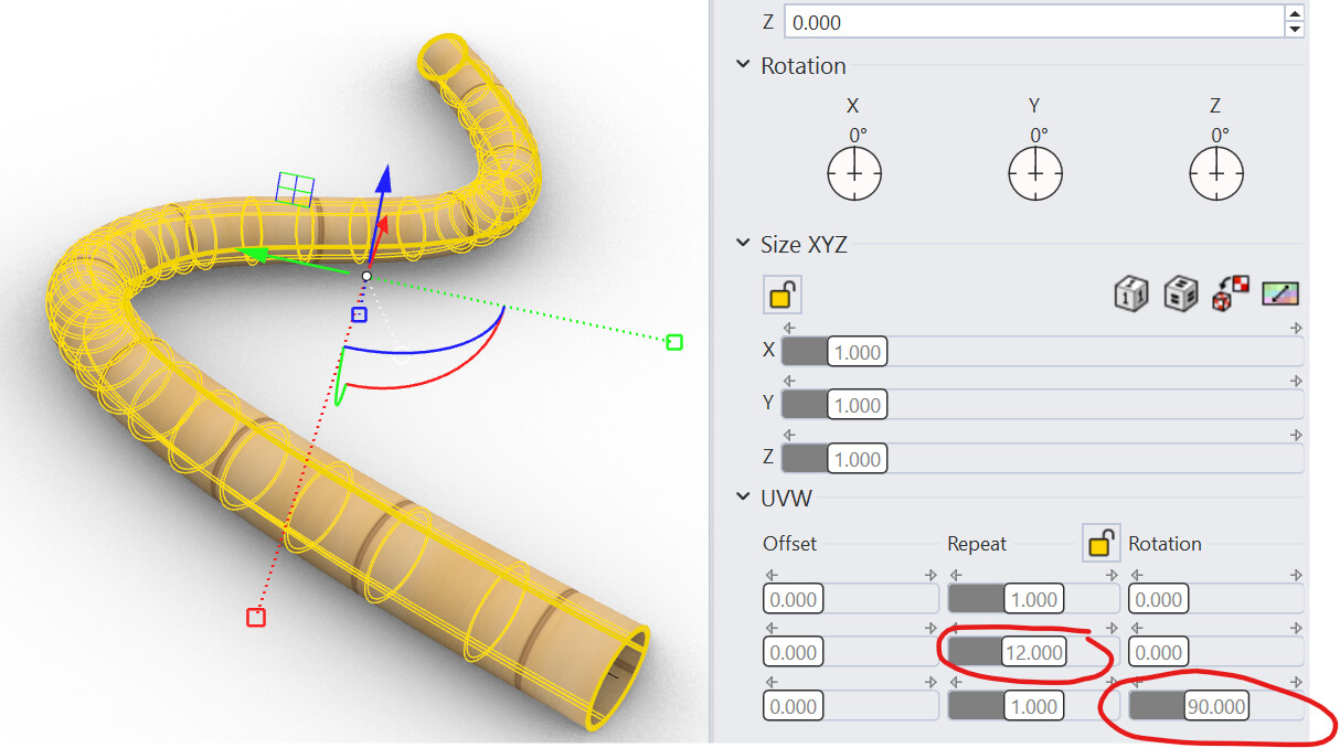

Hi! i am currently doing a bamboo project and have no idea how to make the pipes look like bamboo with real life textures. tried to search online but got no answers. Got nothing when i searched up bamboo PBR materials. Please help me :frowning:
You’ll 1) Need really good bamboo texture/material (probably the hardest part). You’ll probably need multiple textures if you want photo-realism. And 2) You’ll likely need to do some manual texture mapping. It doesn’t take too long. In this file I had to play with the scales and rotations a little.
Surface mapping seems to be working best for me. And then playing with the scales and rotations. You’ll be able to just match some mapping which speeds things up, but lots of stocks will need their own settings.
