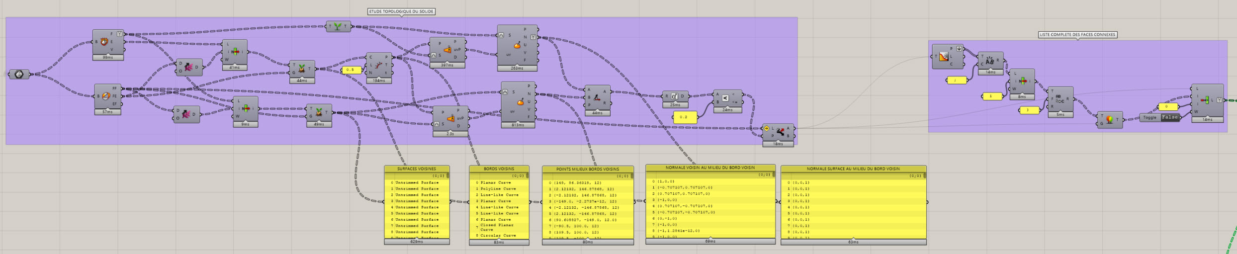

Anemone's "Fast loop end" is... slow
The Anemone “Fast loop end” component take ages to complete although it has very little data to process.
It even takes up over 5 seconds with NO data at all being passed.
Is this an un-avoidable drawback of using loops in GH or is there a better looping plugin that I should consider ?

I need a tree giving lists of faces connected along an edge and also sharing the same normal vector along that edge.
I don’t deal with freaky faces for which the normal vector changes along an edge for example.
The part I give as an example shows this : it is your everyday sheet metal part.
I used the BREP Topology component and normal vector comparisons to get a tree giving for each face, the list of all the faces with adhere to my criteria (including the face itself) :
But then I encountered a roadblock because I need to “concatenate” those lists to get “chains” of faces which are connected according to the above criteria.
David gave me a C# component that “almost” worked : indeed, I had to place it in a loop to make it go through all the trees, and this is causing great trouble in the execution.
Therefor, I started looking into graph theory to produce the doggone list, as I started explaining here.
Sorry if my description of the problem wasn’t clear enough. It just seemed to me such a trivial task at the beginning because unrolling sheet metal is really basic stuff.

Peter, I model my sheet metal parts realistically with the bends, therefore what I said actually makes sense.
Once I have the lists of “tangentially connected faces”, illustrated above, I can sort them based on area.
Here, the “extrados” is the red set of faces ; the “Intrados” will be the blue set of faces, and are respectively the largest and the second largest in area.
Then it becomes easy to offset one of them according to bending tables and flatten that to get an accurate flat version.
I know that other CADs out there have built in tools for that, but for now, we are stuck with Rhino.

Hi Peter, TomTom,
I found my own solution to the problem.
You will probably come up with a more straightforward solution, but you might be interested by my geometric approach.
