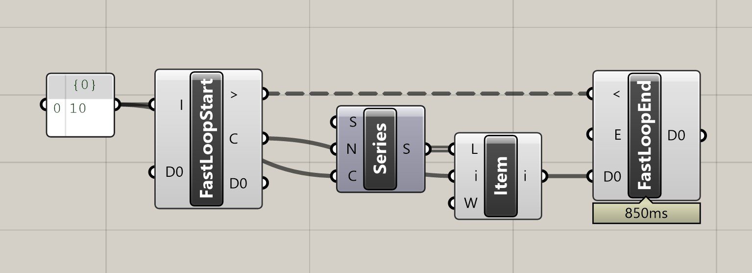

I am working on a project for university, where I am relying a lot on Anemone. Strangely it takes forever to compute the loops - even with very simple operations. As seen in the screenshot, I am just going through the items of a list, which takes around a 1 second. Other operations like blending a set of curves takes even more than 4-5 seconds.
The problem is, that those seconds acumulate, which results in a VERY slow gh-definition.
Interestingly, when I paste a definition which blends together some curves into a new gh file, everythings runs completely smooth (11ms vs 753ms)…

I tried to isolate the issue… whats interesting, is that even when I run a ridiculously simple loop, like going through a number series it is still very slow.
Whats more, is that I am working on a bigger skript and the more components the script has, the slower it gets, as can be seen in the screenshot below.

I’m not expert regarding Anemone, but could it because the “Record” option is on fast-loop-end component settings?
Here is an example of a crazy simple loop… The problem has to be somewhere else.
Any further suggestions would be much appreciated.
