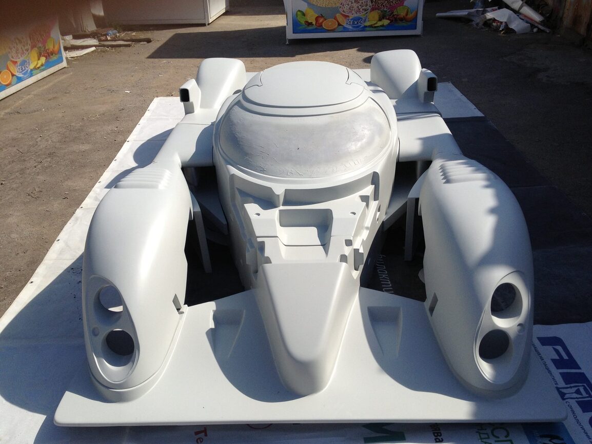

Aeromaster LMP is a replica of the 2003 Bentley Speed 8 LMP prototype car that won “Le Mans” back in 2003. However, some changes and improvements were made on the body to better suit the kit car nature of the built (for example, the original car didn’t had proper weatherstripping on the doors), and the tubular chassis allows a wide variety of engines and transmissions to be used.

Thank you for the kind words! That project was mainly developed between 2009 and 2011, and I consider it as my biggest step into the free-form modeling with Rhino, because it had some challenging complex surface transitions that required lots of experimenting with new techniques. Bentley Speed 8 is the perfect car model for Rhino CAD modelers to improve their skills and I encourage everyone to try to recreate it.

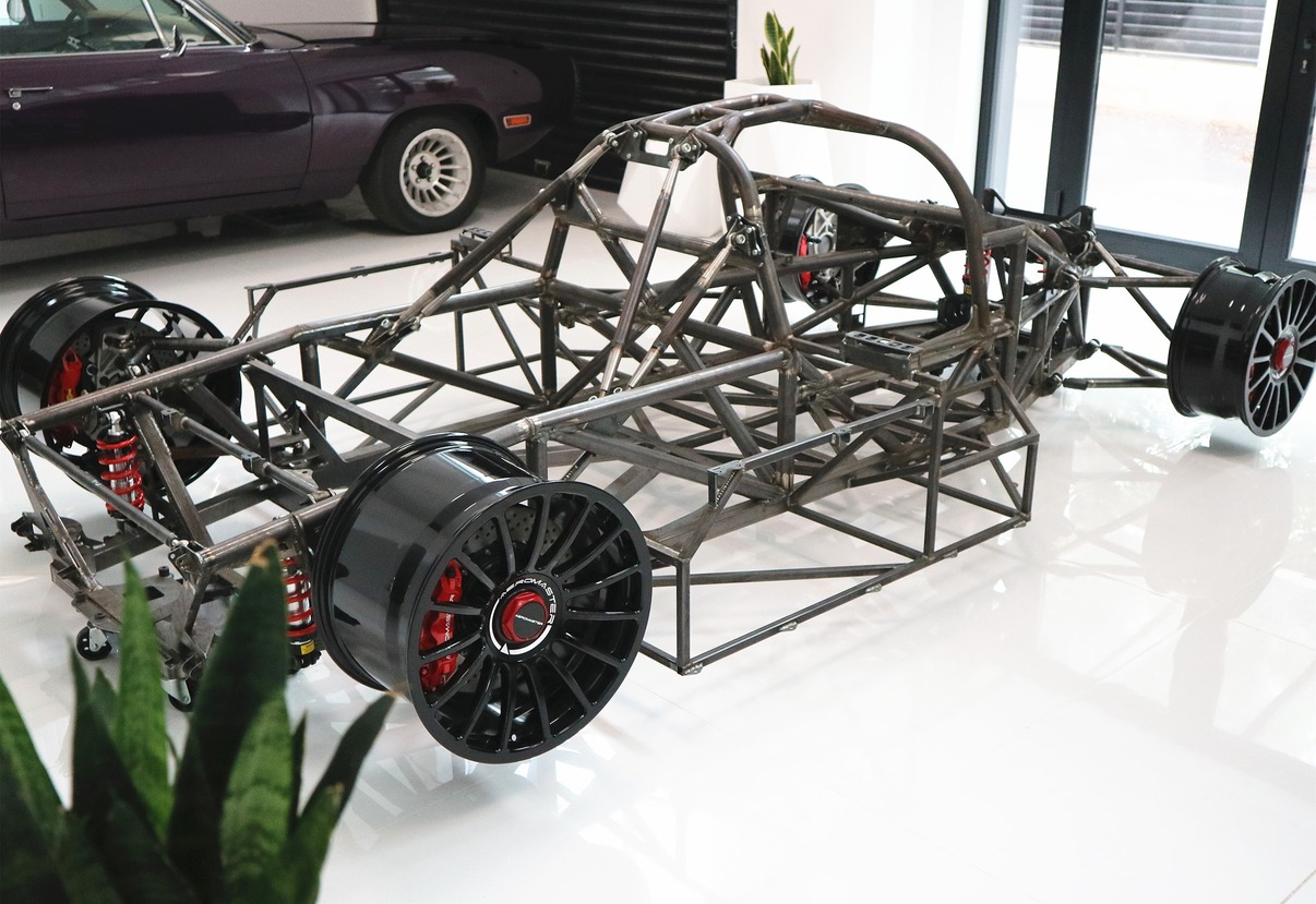

Thanks! It’s fascinating to experience the development and build of such a project from the ground up. The first new Pro chassis with Ø45 mm tubes already takes shape and will be ready soon. :slight_smile:
Now that we have the new Aeromaster custom rims and custom brake calipers in place, the most fun part comes to install them on the first prototype Aeromaster Pro chassis whose welding just finished. :slight_smile:
Test fitting of the main suspension components on the bare chassis. Can’t wait to see it painted in charcoal dark grey. :slight_smile:

Hi Bobi, Thats coming along nicely. Which three bolt wheel hub bearing housings are you using on your suspension uprights. Ford, Audi or some other?
Hi, I’m using Corvette C5/C6 hub-bearing. It’s a simple proven design and easy to supply in most countries, this is why I use it for my projects since nearly 15 years. :grinning:
That’s a surprise, I assumed you would be using something Euro.
Prices of wheel bearings of European models that are designed to withstand 400 HP or beyond are way too expensive. :slight_smile:

This photo of the first Aeromaster Pro chassis is from December 2021. It’s pity that all of this is now hidden under the body panels.
