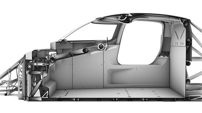

Aeromaster LMP
the incredible bobi it’s so beautiful it makes me want to go and try to learn how to build frames tubes and all that goes with it. you should make your own car brand .
Thank you for the nice words! I appreciate your opinion! You will definitely find it quite interesting to design tubular frames and suspension. :slight_smile: The challenge with problem solving is what makes me enjoy the end result even more.

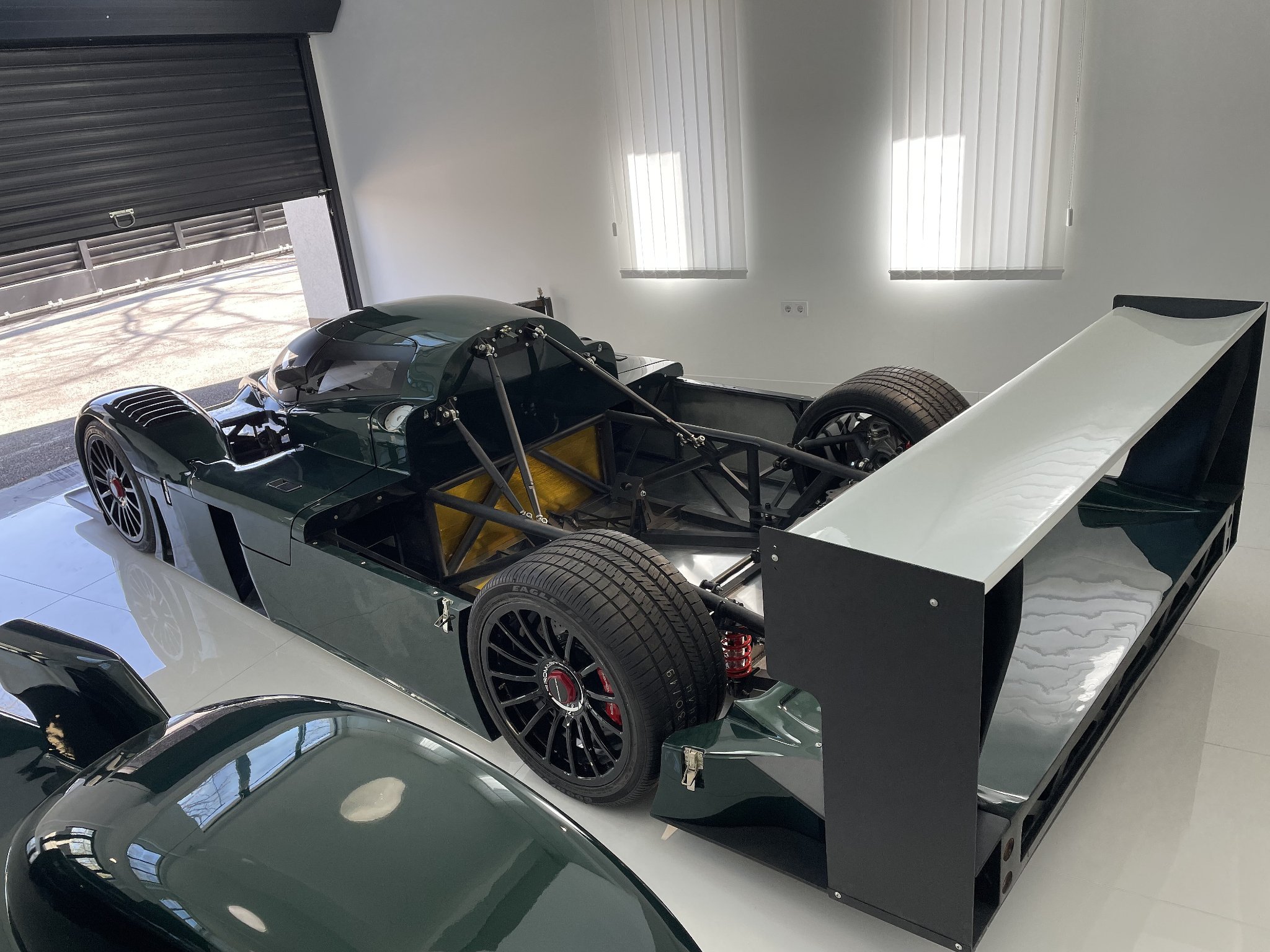

Yet another Aeromaster LMP was built and it got a British green colour and a white livery closely resembling the original 2003 Bentley Speed 8 LMP prototype. :slight_smile:
positively amazing work… thanks for sharing!!
Thank you for the appreciation! Another one is being built right now and next month I will be able to show some new Rhino modeling.

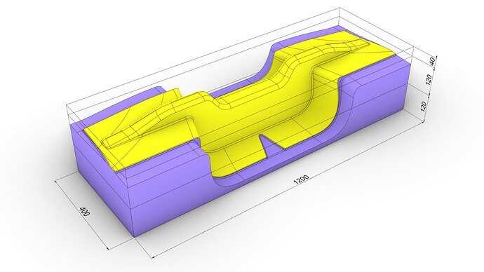

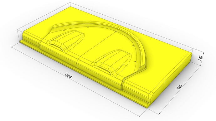

Various plugs for CNC-milling of the interior panels and exterior panel reinforcements:
Reinforcements for the engine cover:

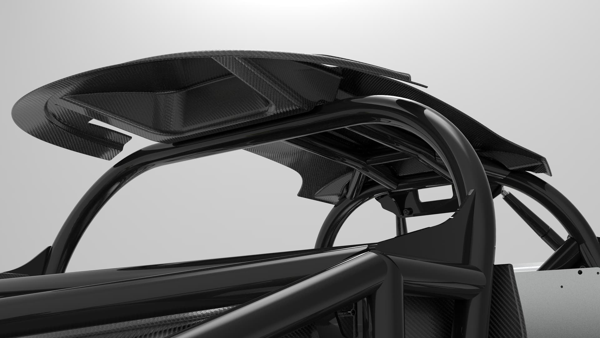

Roof mounting panel:

The model shown in this particular example consists some areas with negative draft angle, which usually require a large and expensive 5-axis CNC-milling machine. However, there is an easy solution to achieve that with a basic 3-axis CNC-milling machine, in order to reduce the overall manufacturing cost. It only requires to divide the model into several pieces in a clever way, so that the negative draft angle area (located in the smaller of the three pieces) is CNC-milled from top side and then assembled pointing towards the side. This technique makes it possible to produce such a complex model with nearly any 3-axis CNC-milling machine available on the market.
