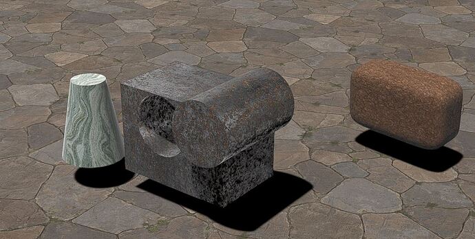

Scott,
Thanks for the link. I created a quick set of objects and added materials from my collection from Substance for an initial test. Looking forward to future updates to your plugin.
