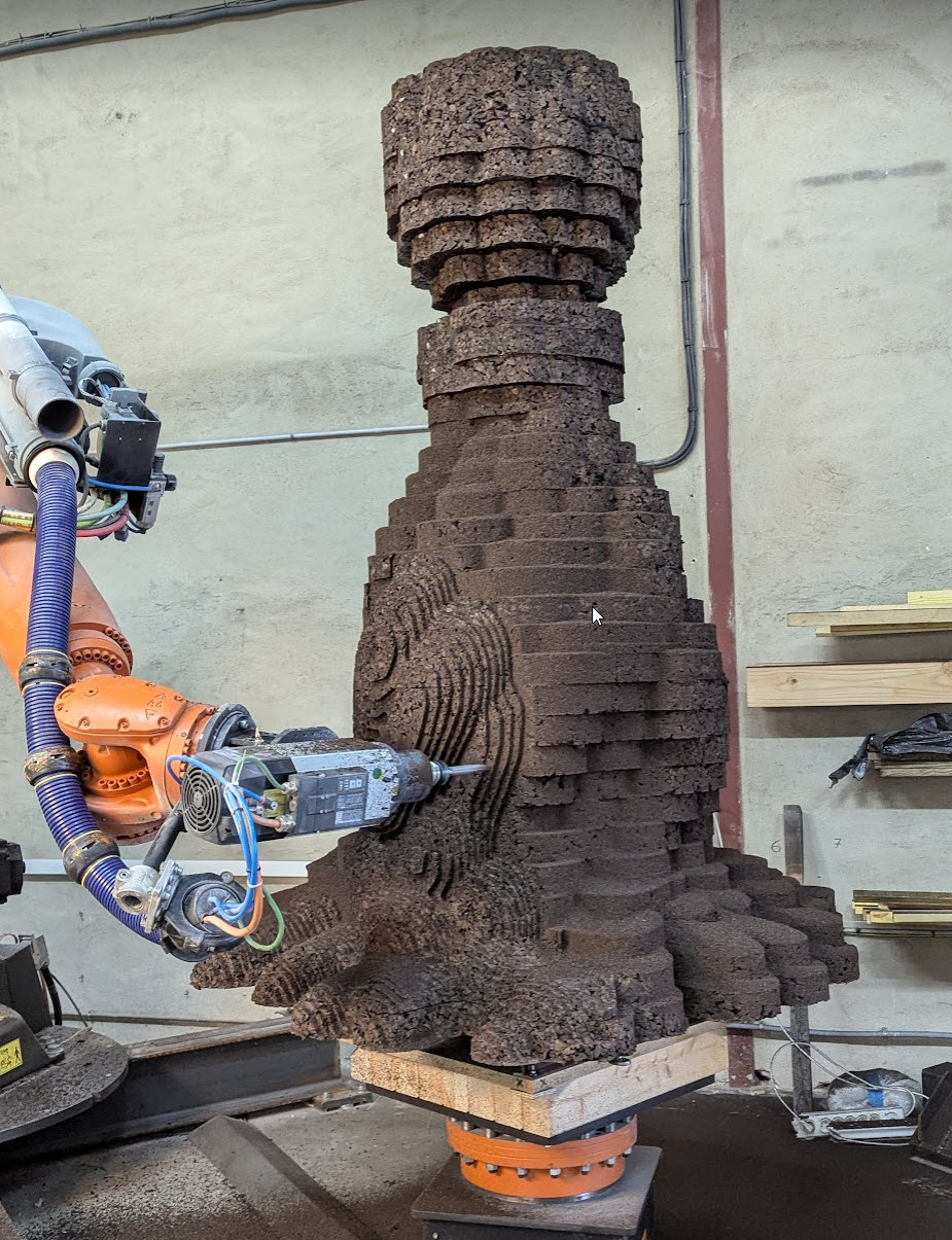

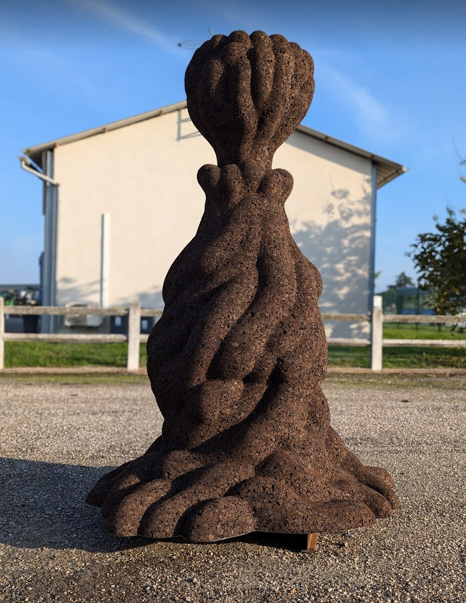

5 axis milling of a cork sculpture using GH and KUKA|prc
For the milling of this 2.1m high cork sculpture, I used GH to optimize the 2D-cutting of the strata for the stock shape (with the help of Open Nest).
I scanned the stock to check if the part fitted inside (Reality vs CAD).
Then, the roughing paths were generated in Fusion 360 and simulated+exported to the KUKA robot with KUKA|prc.
Finishing used an in-house 5 axis toolpath generation definition with collision avoidance.

Here, all 7 axis are at work, in fact.
Here are un-edited (a bit boring) videos of :
ROUGHING “3 axis sequential” (Table turning 4x90° to knock out the “steps”)
FINISHING “5 axis continuous” (Syncronous table+robot operation)

Love to see it! I don’t think we get too many KUKA posts (we have 3 in my lab at school). Never really thought about milling cork. Can you explain your material choice? Lighter result, maybe? Normal end mill bits? I know thinner cork laser cuts well, but it looks like you did some 2-axis milling of the flat parts, first.

It’s not my choice, but that of my client.
They like using natural materials.
These cork slabs are made from steam-pressed cork crumbs, and the process releases tannin that acts like a bonding agent.
It is a bit fragile, but very pleasant to work with, as it smells like smoked tea.
I used regular wood roughing mills and for the finishing, a special mill normaly used for polystyrene.
