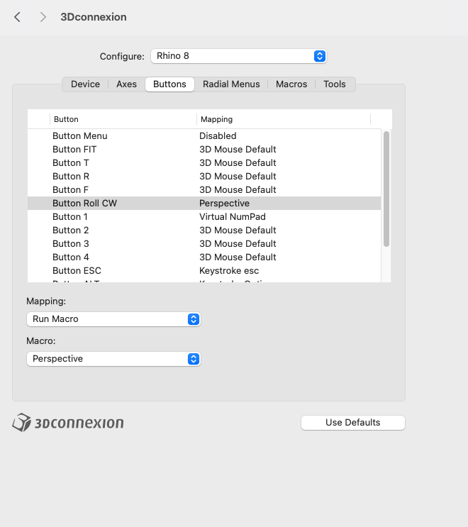

I’m trying to setup my SpaceMouse Pro in Rhino 8 (again, since none of the settings from Rhino 7 carried over…). My issue is the dialog in Rhino’s settings allow me to change some buttons, but other buttons there is just no option at all. It also doesn’t include any options for pan/tilt/zoom.
The only option seems to be to use the 3D Connexion program in system settings also to fully customize my spacemouse.
Are there any tips on how to customize a spacemouse without using two seperate dialogs (one in rhino, one in System Settings on the Mac)? The options I’ve set in the Rhino dialog work great, but that dialog doesn’t recognize other buttons i need to change. Button 5 and Button 6 are great, but i have no option to change to perspective or top views using the same type of commands on different buttons.
so i have to use the 3d connexion dialog with weird macros that only kind of work.
sorry this is so long, any help would be appreciated.

In the rhino setting, just leave Button #2 with a command [as you already did].
No Need to deal with the Rhino setting page beyond that
And then assign all the other buttons through the 3Dx setting in System, and it works fine.
For me [with Enterprise device] it worked best to assign in Rhino hotkeys to the command I want to use [including view manipulations]. and then assign Macros in the 3Dx page [so you have the commands names and you don’t need to remember the hotkeys]
HTH
