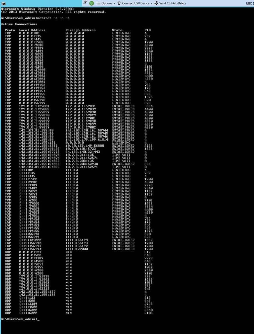

I’m trying to upgrade our Zoo license server from version 6 to version 7.
7 seems to install just fine, but after doing so port 80 is no longer listening.
I don’t know why…

I’ve since reverted back the server to a previous snapshot, but I can tell you that if I attempt to telnet to the server from a remote system it won’t connect.
There is nothing to accept the port 80 connection after upgrading from Zoo 6 to Zoo 7.
Running a netstat on the server with Zoo 7 installed also doesn’t show anything listening on port 80.

I had another go at things tonight and have much more information:
It seems this isn’t just an issue upgrading from Zoo 6 to Zoo 7 on our server. The “update available” function within the Zoo admin console produces a similar result where port 80 stops listening.
Here’s what I was able to collect:
Hi @chris.huzyk,
A couple of things to look at and/or try:
1.) If the Zoo couldn’t listen on TCP Port 80, then I’d expect the Zoo service to fail to start. The fact that the UI is running conflicts with what you saying. You might check the Window Event Log to see if you find anything. From within the Zoo Administrator, click View > Event Viewer. When the Event Viewer open, navigate to Applications and Service Logs > McNeel and see if anything stands out.
2.) The Zoo installer adds both inbound and outbound rules, named Zoo TCP Port 80, to the Windows Firewall that ensure TCP Port 80 is open. You might confirm this is the case. If you are using a different firewall, then you’ll need to do this manually.
3.) The Zoo Diagnostic utility has two Zoo-specific tests: Zoo Port Check (#4 ) and Zoo Connectivity (#5). These are important tests to run:
ZOOPORT
Host "zoo.mcneel.com" listening on TCP port 80.
ZOOECHO
Connectivity test with the Zoo server "zoo.mcneel.com" successful.
Let me know if any of this helps.
– Dale

The problem was the firewall rule got changed to only allow connections from the local subnet.
Easy fix. Next time I’ll give myself a proper change window so I can poke around a bit to spot something like this before reverting back.
