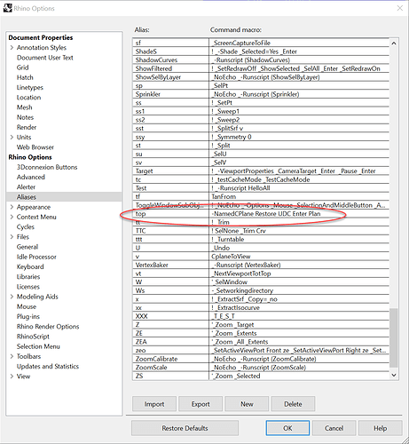

Hello - yes, you can set up a new macro to set your custom plane
top = `-_NamedCPlane _Restore UDC _Enter _Plan’
oh this is one level deeper level that I’ve never explorered. Thanks!
