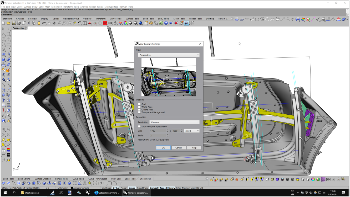

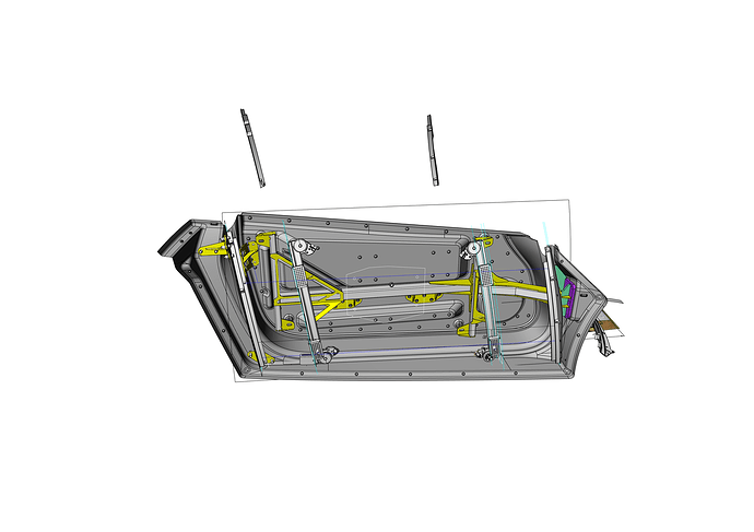

Wish 1. It happens so many times that when I want to capture a screen-shot of the viewport, Rhino will show me a misleading preview regarding what the command will actually capture in the image file. Example:
The preview while making a 4K (3840x2160 pixels) screen-shot is relatively accurate:

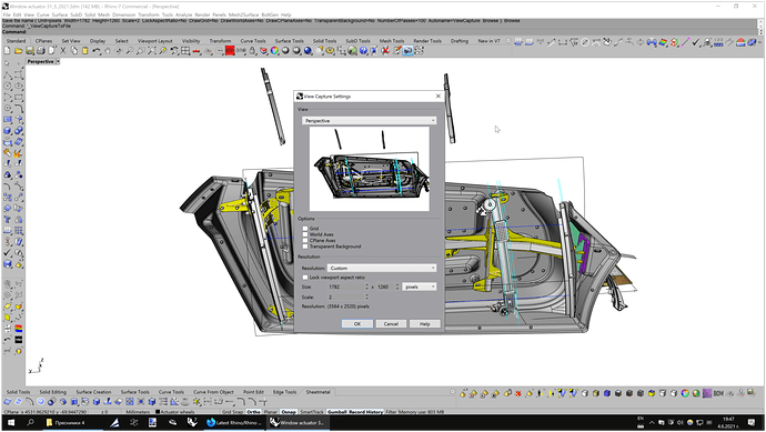

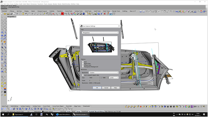

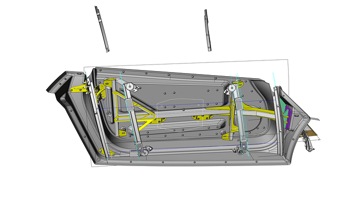

However, making a screen-shot with an aspect ratio set for printing on paper sizes A3 and A4 (3564x2520 pixels) results into a misleading preview that does not match the actual output image:
In order to make a nice close-up screen-shot of the part, I have to zoon-in way too much and must do a lot of guess-work (sometimes doing several trials/errors) to figure out the proper zoom ratio and position of the camera relative to the part. Notice the small preview window that shows a small portion of the door panel, whereas the actual saved image shows the entire door panel:
