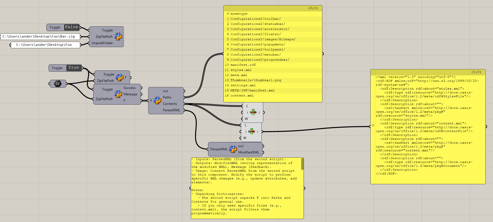

Here is a component that can unpack ODS (ZIP) files into Grasshopper.
UnzipFile.gh (12.1 KB)
