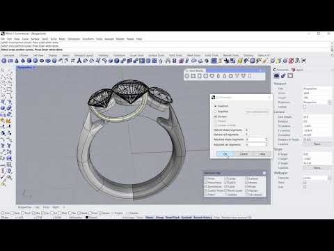

I model many things that require symmetry. Currently, I have to build one side and manually mirror it over. Often I do this in stages, mirroring sections as I go along. This is ok, but often, history may not be enabled and not rigoroulsy monitored, I also use the 'Symmetry tool, but it’s not quite the same?
I can see the need for an mirrored modeling toolset that display a mirrored preview across a line of symmetry. Perhaps this could be a preview, that you can ‘bake’ when ready.
Yes thanks. I use both these approaches but I think mirrored modelling should just have a simpler approach. It could be a check box, for example which toggles mirroring on and off. This could be in the panel area and give the option of which plane to mirror around.
I’ve seen this done simply with the render mesh- the actual geometry does not mirror, but the rendermesh does giving you a good representation of the whole-

Hi - So I made the suggested grasshopper test from TOMI.
I works really good, I even can Filter it to a specific Layername (I called my Layer “Sym” )
Shading is a little off, but that still quite usefull!
Only frustrating thing is the performance… It gets really unusable if you have a lot of geometry on that Layer…
This could be really usful- when I dont have to Mirror the real geometry - but only the light rendermesh!
So a combination of Grasshopper and the Workflow that Kyle mentioned could be a solution.

This functionality is actual pretty banal to rebuild in Grasshopper…
It does nothing but mirroring the Geometry on the xz Plane, (for optimal performance better use the Rendermesh) you dont need access to that mirrored Geometry, its only a visual representation of the content of a tagged Layer (in my case *_Sym named)
The geometry pipeline component actually has all the functionality you need- (layer filtering!)
This is quite a good prototype of what a proper RhinoTool / Layer Option should do!
