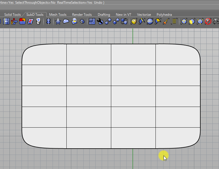

SubD selection, and even specifically Paint Selection has been explained and discussed multiple times here for the 8+ years MCNeel has been developing SubDs.
Herés one of my gripes and frustrations with paint selections: Basic polygon selection is painful, slow, unreliable. Example attached - #19 by RIL four years ago. Still no improvements in sight.
