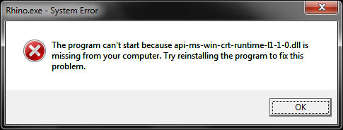

I tried a number of times to install the WIP. It seems to install properly, but when I try to run RhinoWIP I get a message saying “api-ms-win-crt-runtime-l1-1-0.dll” is missing:
I am installing alongside a stand-alone version of Rhino5, am using Windows7 and have tried both standard Install and Redistributable Install and get the same problem, if that helps.
Any ideas? Could you perhaps supply the dll and let me know where to put it?
(Brian Gillespie) #2
Hi, That’s weird…
api-ms-win-crt-runtime-l1-1-0.dll is supposed to come with the Microsoft Visual C++ 2015 runtimes.
Please try this:
  1. Uninstall Microsoft Visual C++ 2015 Redistributable (x64) from control panel
  2. Install Rhino
Now does Rhino start?
#3
Thanks for the quick reply, but it didn’t work. It re-downloaded the 2015C++ Runtime but couldn’t install it
I also tried to install the 2015 package manually from the “Redistributable” install method but it wouldn’t install. I also downloaded the redistributable from Microsoft and it wouldn’t install!
Hangs at the very end when it is trying to install “Windows7_MSU_x64”.
Not sure what you can do to help if MS’s own redistributable won’t install for me…
(Brian Gillespie) #4
I can’t tell from your description if you first uninstalled the runtime - did you?
Also, be sure to restart your computer and apply any pending Windows Updates - sometimes Windows Update can make a mess of installation processes.
#5
Yes I first UNinstalled the runtime.
This morning I managed to get it working. After a night with everything UNinstalled and turned off it seemed to behave better this morning. Installed the runtime from the rhino-downloaded Redistribution (tried Microsoft’s runtime, which installed also, but was a few minor versions numbers older than the rhino version so rhino still wanted to install its own version).
So SUCCESS!
I had to turn off OpenGL Hardware Acceleration so that the screen rendered properly, otherwise all viewports were completely black - don’t have this problem with Rhino5 which renders fine with Acceleration on! (onboard Intel HD 4000 graphics)
Many thanks for your help.

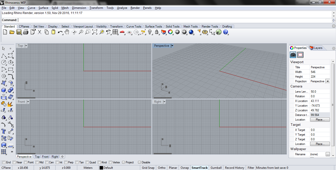

#10
Steve,
That trick worked great. I have disabled the Hardware Acceleration and have got my viewports back.
It doesn’t display the font on the viewport axes properly:
as the “X”, “Y” and “Z” (and possibly the “GPU Disabled” message) is shown as a grey block rather than as individually recognisable fonts.
I can obviously live with it, but thought it might help you debug what is going on. (It doesn’t occur when I start the WIP in safe-mode).
Paul.
(Steve Baer) #11
Safe-mode doesn’t actually use OpenGL which is why the display is different. Please continue to try enabling HW acceleration with new WIPs. We don’t want to mask the bug with the current approach.
