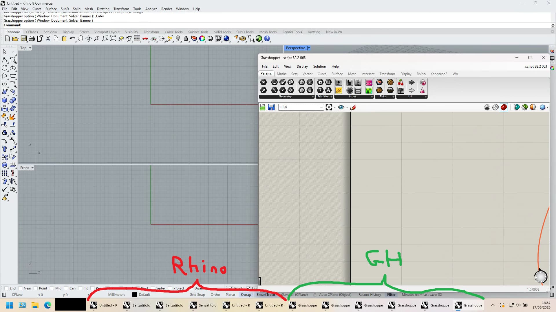

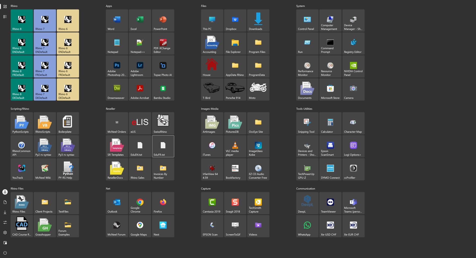

I have Start11 installed on my two Win11 machines - I don’t know if it fixes all your issues, but it does fix some taskbar stuff. Plus I use it to heavily customize my start screen. I will check more later when I get back home.
Edit - here is what my W11 taskbar looks like under Start11 with 3 Rhino V8’s open plus GH in two of them and ScriptEditor in one.
All the Rhino’s are separate icons (that is a setting in Start11). GH definitions open do not get a separate icon in the taskbar, but the script editor does. I mainly like Start11 for the custom tiles start screen, which I have been using some form of since Windows 8. Set to come up when I hit the Windows key, instant one-click navigation to my most used programs, folders, websites, etc.

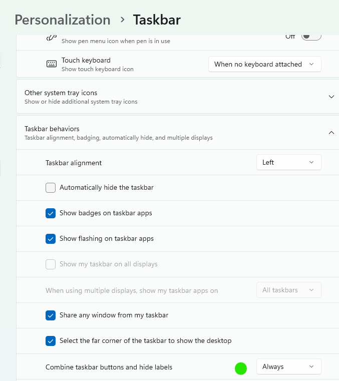

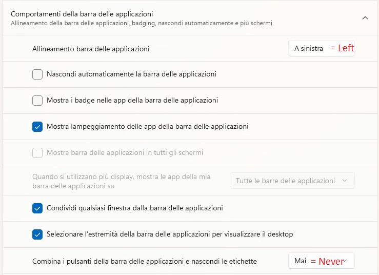

What are your windows settings?
Setting last option to “Always” doesn’t seems to help. The tooltip popping-up is the same…
Even in the tooltip you can’t read the .gh filenames due the “Grasshopper” start part…
