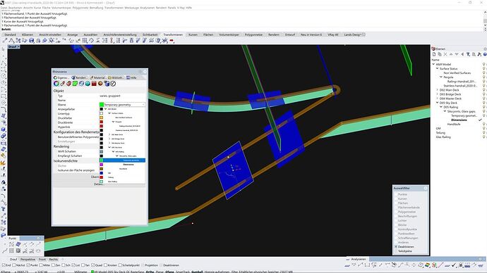

Windoof Update scrumbles all sizes of Fonts, Icons in Rhino
But it seems only in Rhino.
Icons were smaller than before, text in the Layer window is not readable.
No idea what’s up.
Anybody similar experiences?

What Windows version? What Rhino version?
Windows 10 and Rhino WIP. Just seen, that Rhino looks as it should.
Thanks.
Hmm, so everything ok then?
Sorry, Rhino 6 looks fine. WIP has the fonts in the layer window very small for example.
Are you on an high DPI monitor? I don’t see difference between before and after Windows 10 update - I installed the latest feature update last week.
My Monitor is a Dell U2711 with 2540x1440 dpi.

As you can see, everything is looking great. Except the layers in the properties window.
And the screen seems to be moved down slightly. Numbers in the small gumball input window disappear half way down.
As can be seen in the 2nd screenshot. Not only the gumball numbers are hidden half way, the gumball is very small and the rhino window is also disappearing at the lower end of the screen.
The Monitor does not allow any movement of the screen. A reset doesn’t bring better results.
Thanks !
Interestingly it shows normal HD defintion here. The reset may have also changed the resolution.
Windows shows HD defintion in the extended settings and 2540x1440 dpi in the standard window…
Rhino 6 looks pretty normal and 7 did also until yesterday morning.
Rhino 6 below. Icons on the left have different size, settings checkboxes below are visible and layers have the same font size as in the main properties window.

I have no ideas… I guess it would not hurt to post the results from SystemInfo in Rhino…
What is your Windows display scaling set to? Is it the recommended for your monitor?

The display scaling is set to 125 %.
Have no clue if it’s recomended, it worked for more than a year on this Laptop.
I’m not sure resolution the monitor is running, as windows says two different ones, as told.
Maybe a restart would at least clear this.
Thanks to all.
Hello - it is always good to eliminate third party plug-ins - odd and seemingly unrelated things can be affected - - you might try disabling VRay in Options > Plug-ins page and then close and restart Rhino - is that any different?
Also, though the driver is not quite old, it would not hurt to get the latest driver for the video card from the NVidia website.
Thanks. I will try one after another.
The one that is recommended should be listed as “recommended” in the drop down list for the display scaling percent in those Windows settings. The clipping of the whole Rhino UI makes me think this is the issue. Windows may have changed the setting on you with an update is my guess.

The update of the graphics driver solved it.
