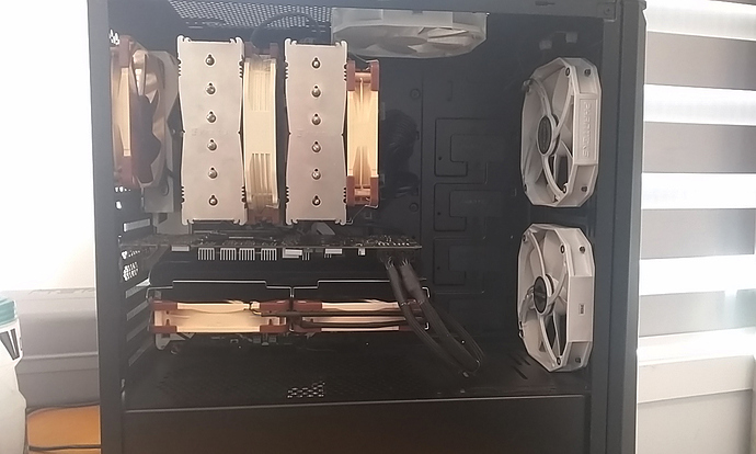

I built a new rig three years ago that was at least 3x more powerful than my old one. I barely noticed a difference with Rhino. With big 2D files it’s still faster to export into Illustrator to generate render hatches. Had I known that I would have waited and spent less. Kicking myself for not waiting on first gen Ryzen.
