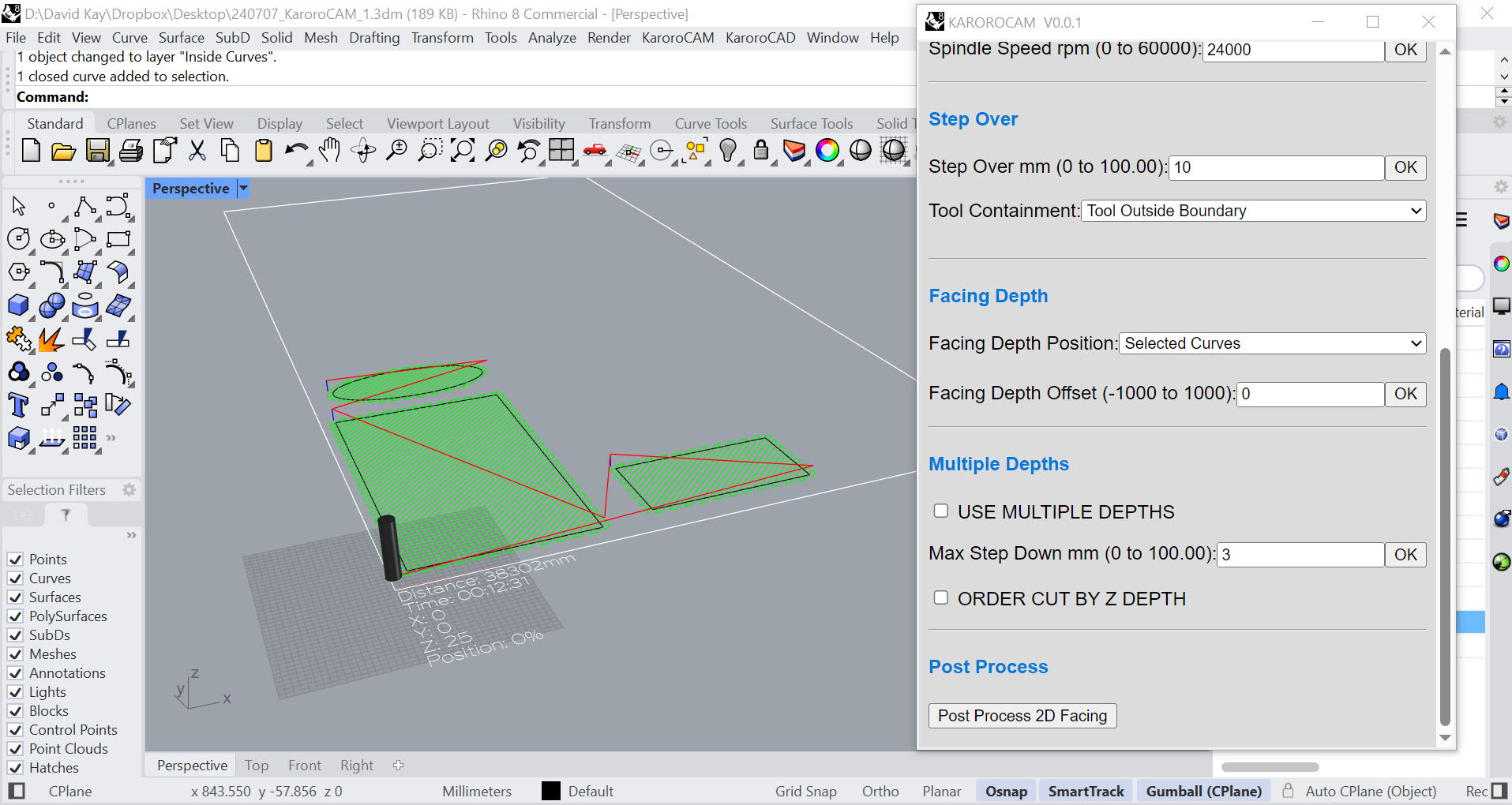

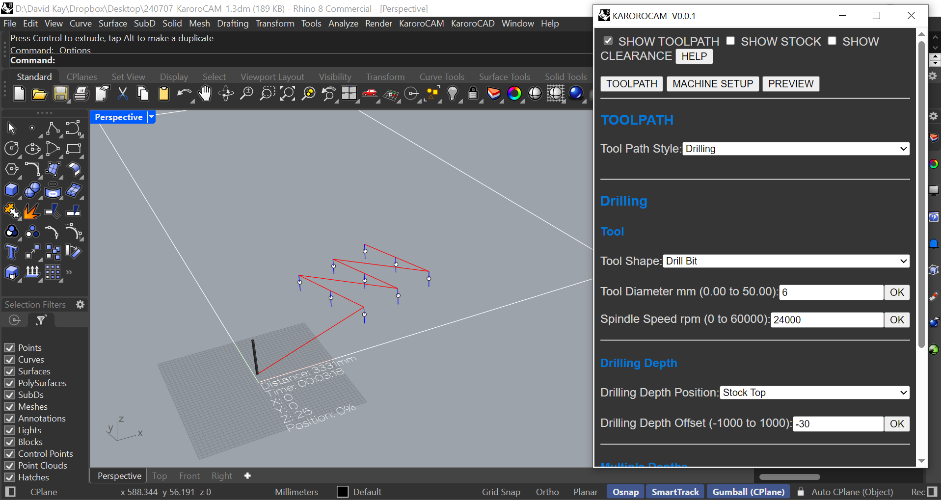

Thanks for all the feedback everyone, as a bit of a tease this is a look at where my new project “KaroroCAM” is currently sitting.
I have prototype toolpaths for:
  • 2D Profile Cutting
  • 2D Engraving
  • 2D Pocketing
  • 2D Facing
  • 3D Roughing
  • 3D Parallel Finishing
  • 3D Trace
  • Drilling
Facing was the latest one built today:
There is a working tool movement simulation:
MacOS is 100% supported:
As is Dark Mode on both Windows and MacOS:
Still a LOT of work to do, but I hope to have something worth beta testing out in a month or so.

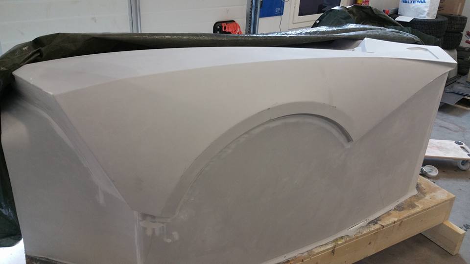

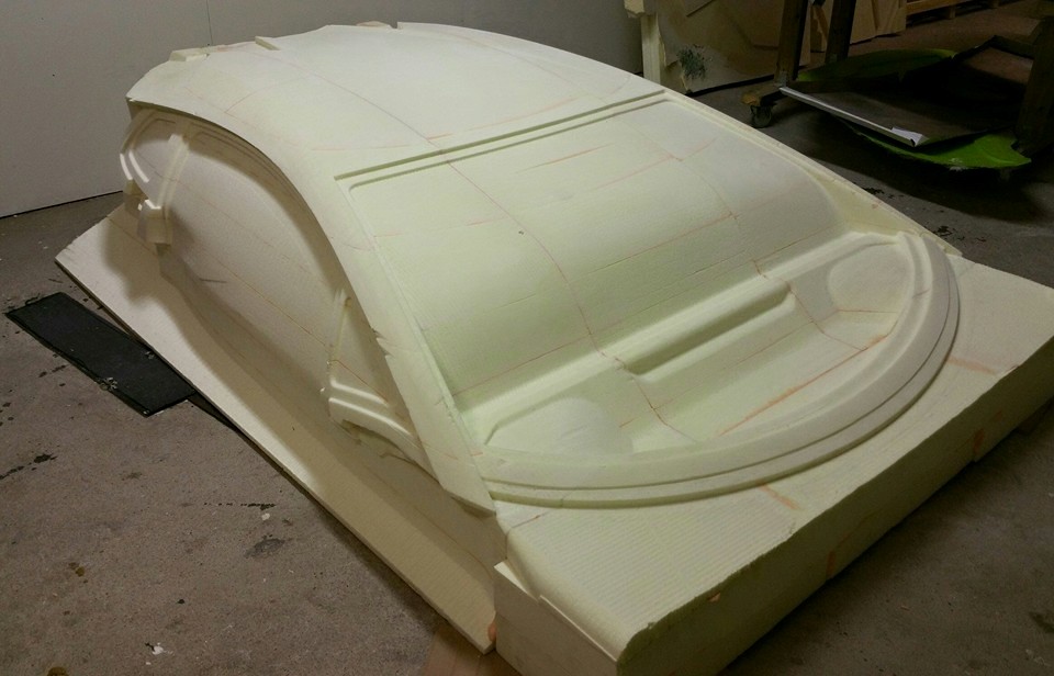

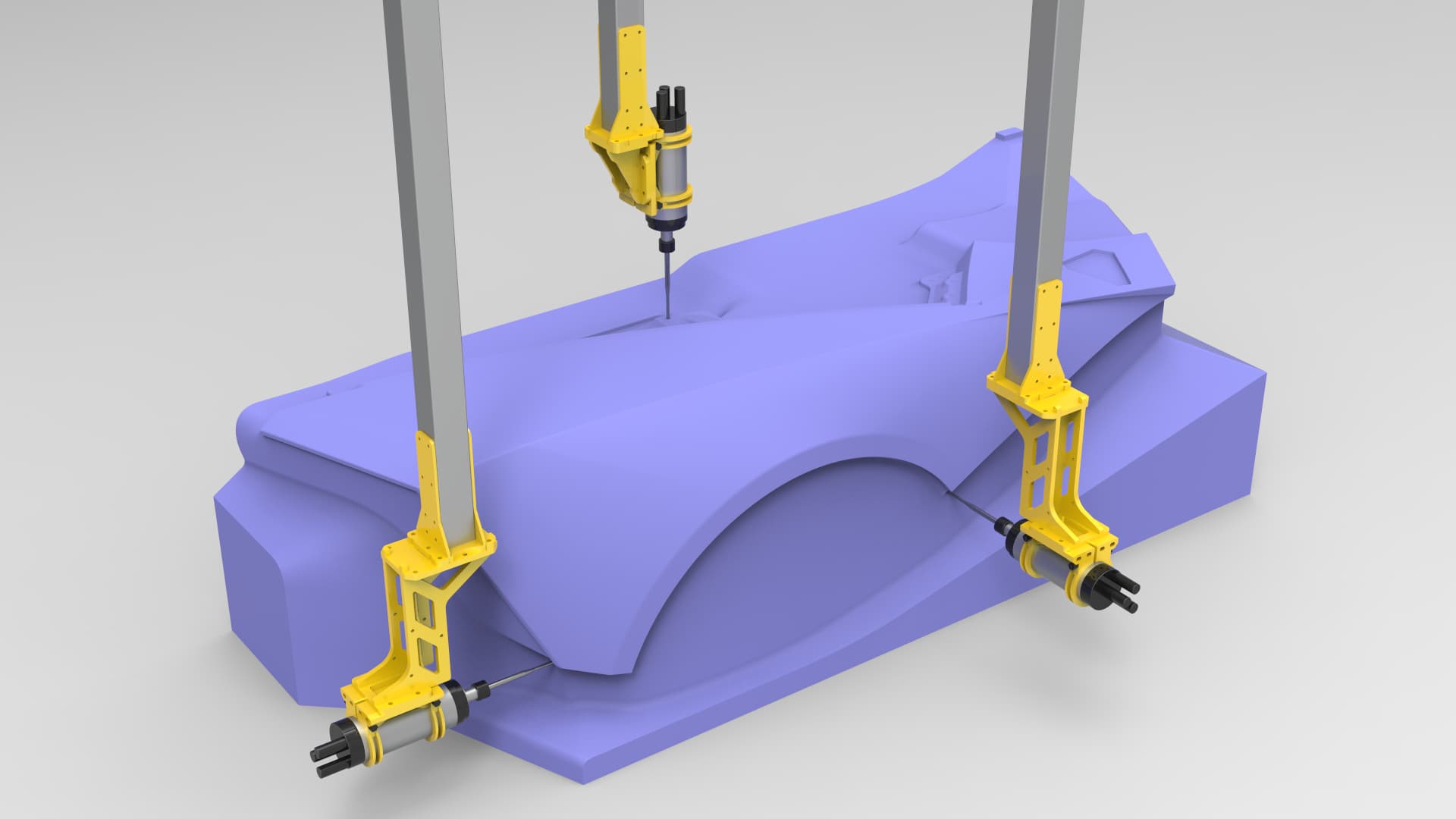

RhinoCAM in my opinion is very user-friendly. About a decade ago l used to work on it for a while. I really liked its direct approach and the ability to copy, paste and rearrange the milling operations.
However, it had one major drawback. The 3d simulation with 5-10 operations on relativrly large objects (plugs for car body panels) often crashed due to quick filling of the system RAM, despite that the visual difference between the operations was minor.
I think that the filling features are very important:
  1. Use curve regions to limit the milling operation. This should suport custom direction of the mulling path set in degrees.
  2. Ability to import own 3d model of the CNC-machine to define the safe area, or simply for convenient decisions about which milling tools to use at certain steps.

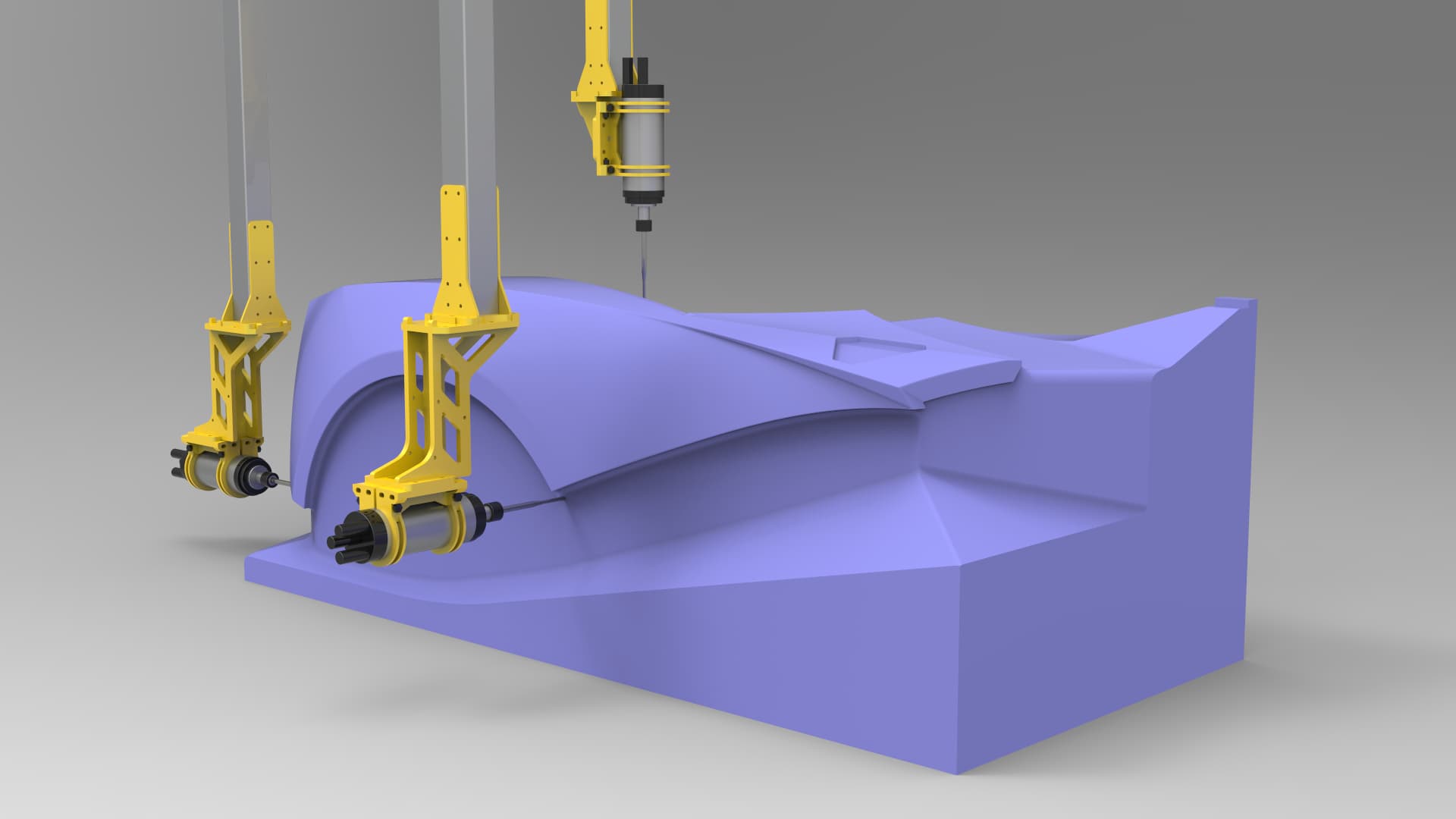

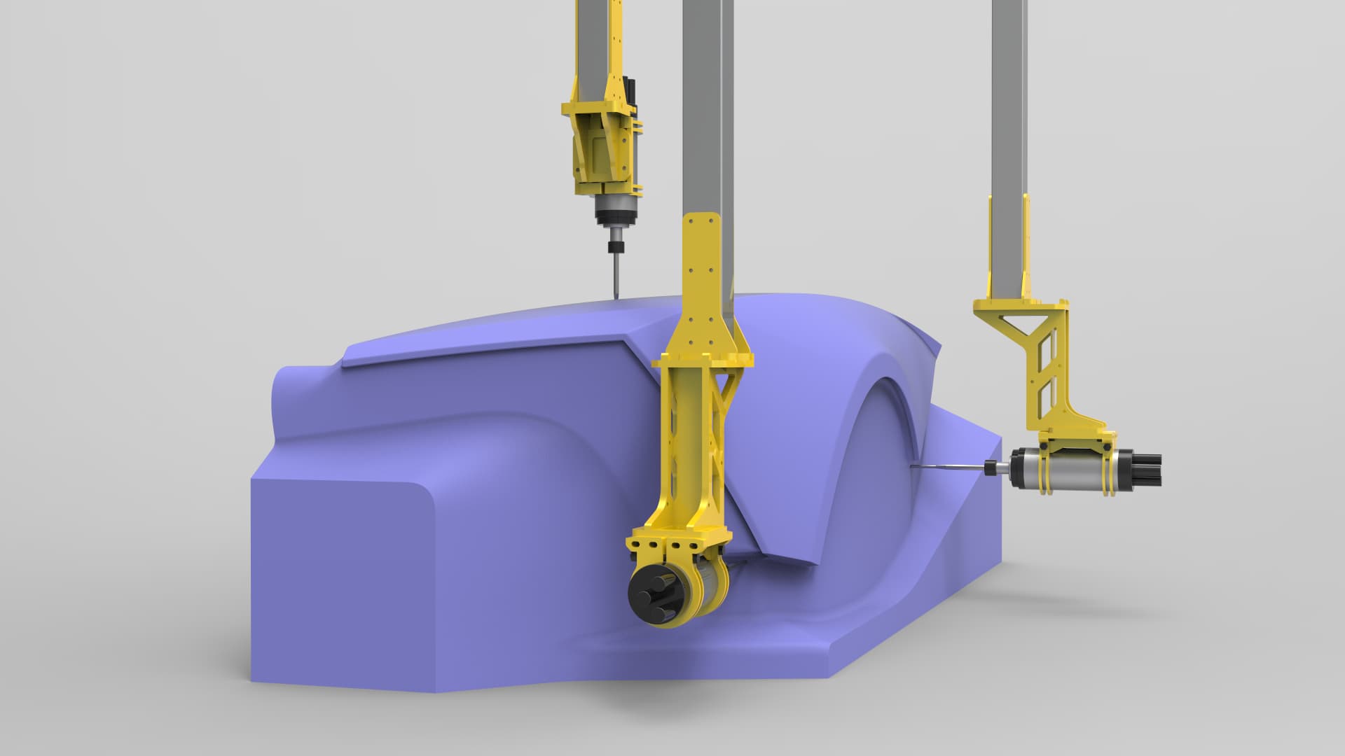

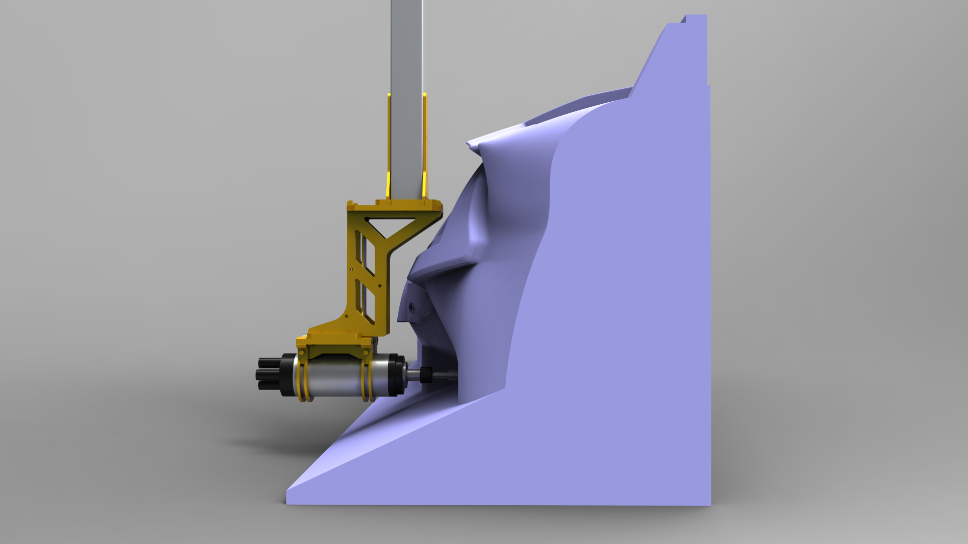

  3. Ability to do indexed miling with rotated milling head. Since this is targeted towards the hobbyists with mostly basic 3-axis CNC-routers, some operations require to manually rotate the milling head by 90 degrees or 45 degrees to reach areas that usually require 5-axis CNC-machines.
The errors around the A-pillar and some other areas were a result of bad G-code creation by RhinoCAM, but this photo pretty much explains the huge advantage of indexed CNC-milling done by a manually rotate milling head.
  1. Ability to (copy and) mirror the G-code horizontally along the X, Y or Z-axis.
  2. Ability to scale the G-code: 3d, 2d, 1d. The latter means that the carving could be scaled vertically to achieve a greater or smaller height of the stock material to create the same part with thicker or thinner material.
  3. Ability to define a custom shape of the stock material. The user must be able to use different stock material 3d model for each operation.
  4. Allow good settings for polygon-based and voxel-based 3d simulation. Fine finishing for the voxel-based simulation should use a refined (more detailed) setting than the initial roughing.
Yes, indeed, personally I am working on creating a CNC machine that have a drilling unit and a C-axis aggregate, which I do need to simulate the movement for.
