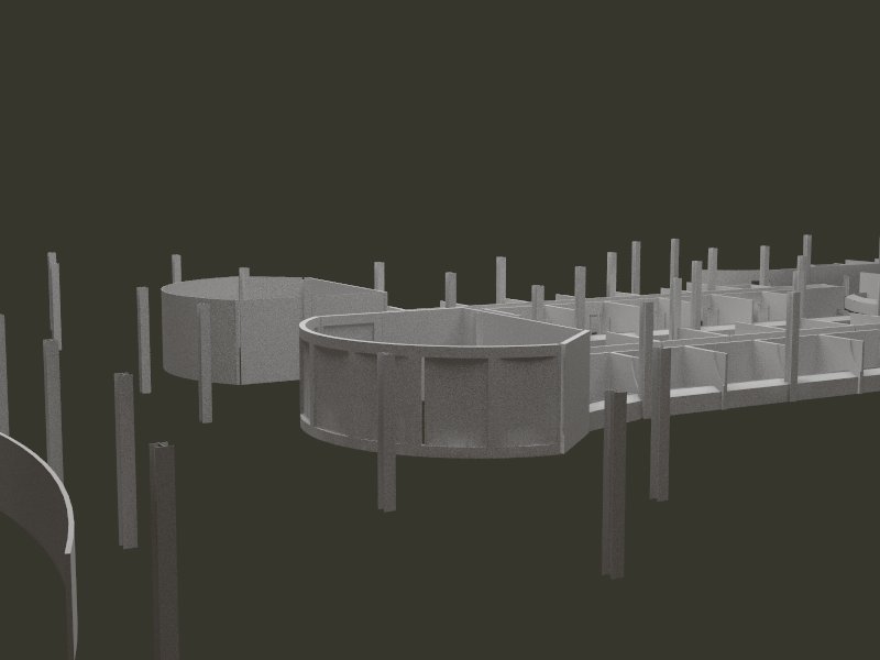

Hello I am using VisualARQ 1.7 and i am not being able to put vray materials to the visualarq objects. I select the window for exemple, and set the material to glass, but still the material of the visualarq model, which is none.
Could some one help me, with even a tutorial about how to render with vray a visualarq model. Also, I don’t know why the background turns to grey and looks like a photografic filter. Please need help.

Hi @Leonardo_G_Pate, you shouldn’t need to explode VisualARQ objects if you want to assign V-Ray materials on them.
If you are using VisualARQ 1.7, I recommend you to download the current version available (1.9.4), which should work fine with this issue. Try it out and let me know if the problem persists.

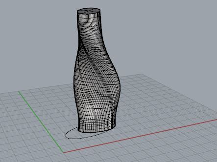

Hi, still wonder how could I make a non 90° vertical wall, and also, how could I be able to use visual arq features in a rhino model like this one.
Visualarq has any kind of guide, or handbook? I am kind of oldschool and this would help me a lot to go further in this magnific tool.
The “vaWallFromSolid” command lets you turn any Rhino geometry (closed solids) into VisualARQ walls. Take a look at this tip: http://www.visualarq.com/support/tips/6596/
But I don’t think it is worth it in this case. You can just work with Rhino geometry and it will appear in plans and section views when you need to generate the 2D documentation.

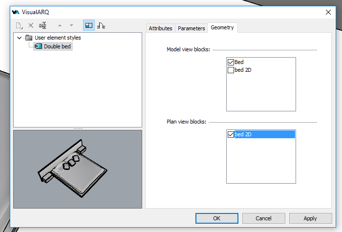

yes, symbols such as level indicator in plan view, main acess, north indicator, projection line, could also add a lineweight scheme so it could import to pdf with proper lineweight also sometimes the connections between many walls together is shaky.
Maybe visualarq could even have a 2d/3d block library perhaps you guys could expand to this area and other architectural presentation need. ’ - haha thanks captain obvious ’ i know it may sound silly, but a block library can illustrate better plan and section views, and maybe this can be a rhino problem, but is very difficult to find rhino blocks on the internet. Rhino is expanding pretty agressive into the architectural area, if it could just have the bim plugin (visualarq) as complet as others such archicad or revit you would detain this much needed feature.

Leonardo, thank you for your interesting feedback. Just to say that the next VisualARQ 2.0 version will include a “User Element” that could be used for this 2D symbols and 2D/3D objects library. It will work like door, window and column styles, which have the option to assign a 3D block and a 2D block for their 3D an Plan View representation respectively. Here you have a screenshot for the first time of this feature:
