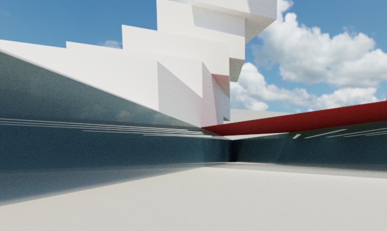

I’ve noticed a bug while trying out some things in V-Ray for Rhino.
Using *V-Ray for Rhino 7 - 6.00.001
If you have a light (in my case Rectangular Light) that you set to “invisible” it will still show in a reflective surface.
Here is what I mean (excuse the low resolution):
1. visible Rec. Lights
2. invisible Rec.Lights (not turning invisible in the reflection of the glass surface)
Would be great if this could be fixed!
Cheers!
Miru
There is a checkbox in the light panel “affect reflections”:
Oh!
That was easy! haha
Thanks! Have a great day pal!
