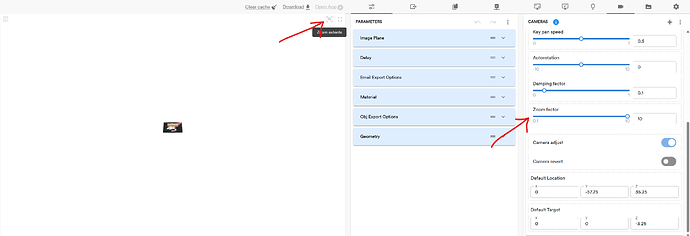

Hello @artmachines,

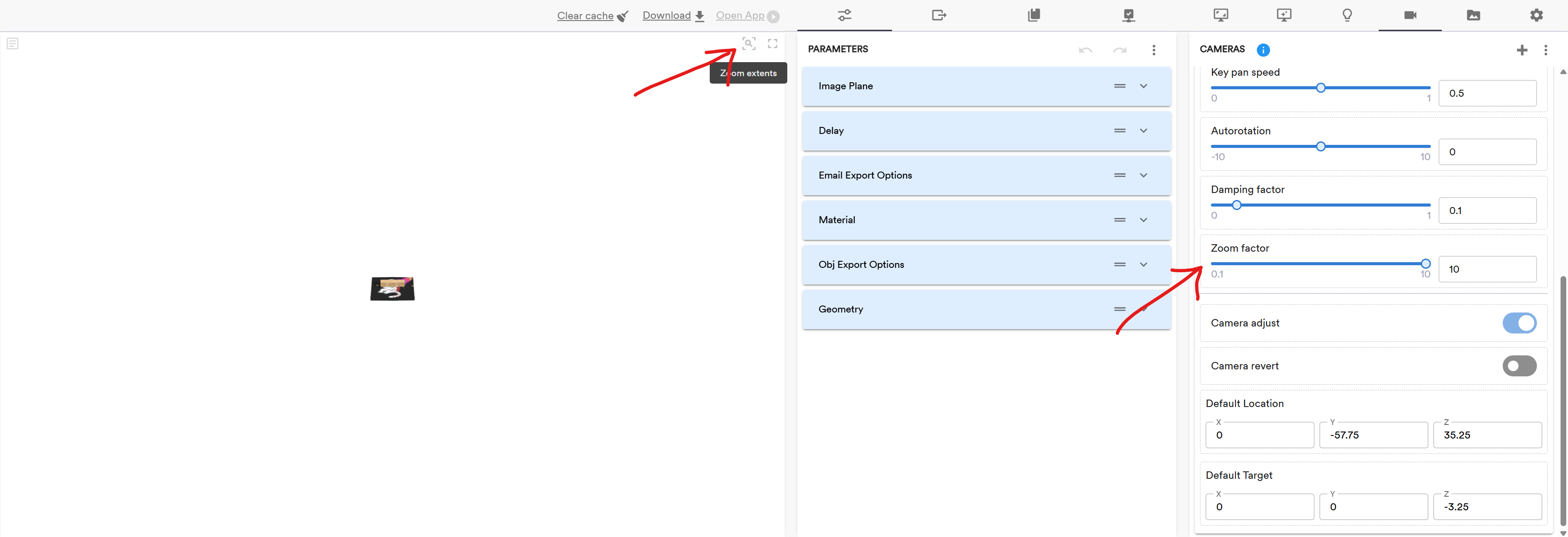

thank you, now I understand your issue. You can change the distance of the camera to the model by using the “zoom factor”. To try it out, change the “zoom factor” and then press on the icon that I highlighted. You can see how the zoom factor influences the automatic camera zooming.
Cheers, Michael
