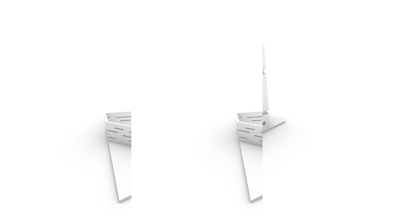

I can’t use viewcapturetofile anymore, ever since i upgraded to Rhino 7. I used to use the feature a lot. Now whenever i set the scale to anything higher than 1 the pictures turn out “damaged” (see pictures).
It doesn’t matter what settings i use, nothing works.
Any Ideas or people with a similar problem would be appreciated! Thx
That looks like a tiling bug that comes up occasionally.
Please run the Rhino “SystemInfo” and post the results.
This will tell us what computer resources Rhino is seeing.
Thanks

Hi -
On macOS, bugs with the display drivers get fixed in the operating system. Is there a reason for not updating to Big Sur?
