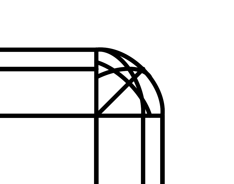

  1. Technical Display mode still makes some artefacts while printing.
    Please, forward this to dedicated person. I’m not sure who is.
    Here is Wireframe to compare.
  2. Clipping drawing cut plane still has see-thru effect. I believe the fix is on testing now?
  3. Print width by layer has no effect on ClippingPlane’s result while printing.
At the same time without clipping it works.

The first picture appears to come from a view in a (modified version of a) technical display mode; the second appears to be a wireframe viewport. When printing to a vector format (pdf/svg), those two different display modes go through different printing engines and I wouldn’t compare a mix of clipped / non-clipped and technical / wireframe output…
While wireframe viewports will export a vector, that display mode is not designed to export vector versions of surfaces. That will simply export the wires of every surface and is not something that is typically desired.

Sorry, my bad. Surprisingly I had two Technical display modes.
I made it single and unmodified and there is no artefacts.
Thank you for pointing me.
Ok. So this fix is still in process.
But it could be the case in some user’s workflow, right?
But Technical mode is already designed to produce vector while printing, isn’t it?
So despite of possibility to produce vector this mode has no way to carry the line print width?
Hi Screamer -
For Rhino 8, that is correct. Visible edges are currently hard-coded to use the Continuous linetype that is, itself, hard-coded to be 1 px. You can change the thickness (and segments length) of hidden edges by modifying the Hidden linetype.
