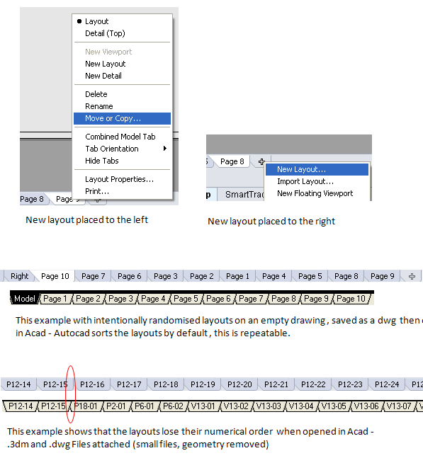

Hi Steve,
I’ve attached a file so you can repeat the loss of layout tab sort order when saving as dwg. I noticed while trying to repeat this on a blank drawing that creating a new layout from right click method, places the new layout at the left end of the tabs list, whereas the + button method correctly places the new layout at the right end of the tabs
V5 - Layout Sort Test.3dm(606.3 KB) V5 - Layout Sort Test.dwg(79.2 KB)

Ah ok, so this is a problem when going back and forth with dwg files. I’ll file a bug report for this. Thanks. Once we have public access to the bugtracker, the issue could be found at
http://mcneel.myjetbrains.com/youtrack/issue/RH-20985

So far, I can’t reproduce this.
When I open the Layout Sort Test.3dm attached here, the tabs are sorted.
When I save it as dwg and open it in AutoCAD the sort order is the same. - There are 2 tabs named P12-14 in the 3dm file and one of them gets changed to Layout16 in Acad, but other than that, the order is the same.
When I read the dwg file back into Rhino, the order stays the same.
I can see that the order is wrong in your dwg file, but I can’t duplicate making it that way.
I’ve just re-tried the example and get the same results as you, so the glitch has disappeared. Must have been unique to me, thanks for investigating Lowell.
