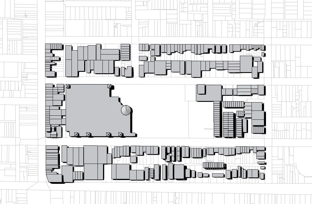

Hi @pascal I am also having trouble with shadows in Rhino 6 raytrace view.
When I create a simple test cube in a small file the raytrace view shadows appear as expected and i’m happy.
However, I am working on a massing model at urban scale and would like to create simple shadow visualisations from different viewpoints to test different building densities. My model file size is large (176MB) due to urban planning linework I think.
Using ‘rendered’ view it works - the shadows are point in accurate direction (according to sun time of day) and I am able to edit what the shadows look like via Rhino Options - Display Modes - Rendered.
Using ‘raytraced’ view it doesn’t seem to work - the shadows appearing on faces sometimes appear to be wrong (according to the sun time of day) and do not appear to be cast on the ground (or if they are it is extremely feint to the point that it can’t be seen). I note that doing: Rhino Options - Display Modes - Raytraced - Shadows - it is greyed out and I can’t change anything.
I know that exporting to Sketchup could work for shadows but I would much prefer to keep my workflow all within Rhino.
Is this a known issue/any tips that I should try? Thanks for your time.
I suppose the secondary lighting is filling in - not super predictably from the viewers standpoint, but probably depending on polygons and scale - @nathanletwory will know.
I’m not sure what raytrace will get for you that Rendered cannot, even if it ‘works’.
If you want to do this kind of “dark” shadows (i.e. no diffuse lighting into shadows) then you should go to Tools > Options > Cycles and set diffuse bounce to 1. Further in the Lights panel turn off skylight, because it is also filling your shadows .
edit: if you set diffuse bounce to 0 you get something very close to Rendered mode.

Hi @pascal @nathanletwory
Thanks for your responses.
I worked out why shadows weren’t working accurately for me in raytraced mode - I think the combination of a very large file size and it being in the ‘real world’ GIS location (very far from origin) was causing problems. I moved it to the origin and they are showing accurately now.
Posting this in case anyone else has the same problem. Thanks again.
